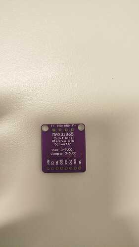

I'm doing an experiment in which I'm going to compare the readings in temperature of a LM35 sensor and and RTD Pt100 (2-wire), using the MAX31865. I connected the circuit as the image shows, using the analog pin A0 for the lm35, and the max31865 pins were connected as follows:
Vin -> 5V
GND -> GND
SCK -> D13
MISO -> D12
MOSI -> D11
CS -> D10

When I run the code, the lm35 readings are great, but the RTD show only 988 degrees, or -242 degrees, the same 2 values in every reading. The "Raw" status show as "Zero" in the serial monitor.
Is there something wrong with the code? I tried to fix it in various ways, but the problem persists.

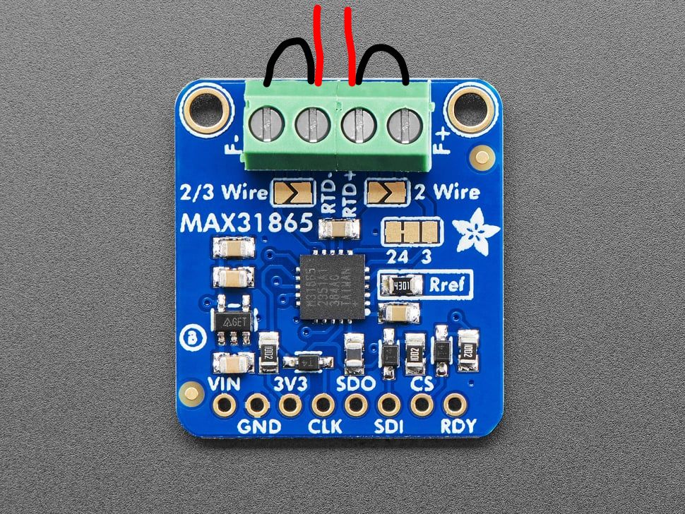

Also, what would be the correct way to connect the RTD in the max31865? I read that I should connect both wires in the RTD+ and RTD- of the module, and then make a short circuit between F- and RTD-. Is there something wrong with that project?

Are you using the Adafruit MAX31865 RTD PT100 board?
Did you short the jumpers for 2-Wire RTD?
I'm using this ma31865 module. I used previously a MAX31856 module, bought at the same store, and it worked with the adafruit library, so I would assume it works with this MAX31865 adafruit library too.
I didn't try to connect the wires like that. I will try it again and return if it works. Thanks for the help!
It worked! I was missing the short-circuit between the RTD+ and F+. Sorry for trouble, and thanks a lot for the help!
