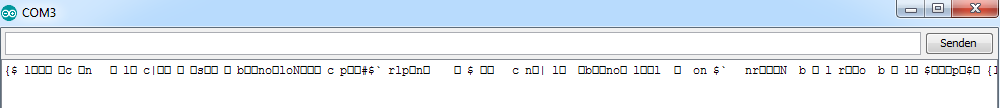

I use the following circuit to flash my ESP12E -> see attachement. The flashing works (baudrate 115200, Board: NodeMCU 1.0 (ESP-12E Module)), but the program won't start. All i get is a cryptic output in my serial monitor when i reset the ESP12E.
So my flashing-sequence is the following:
GPIO0 is connected to GND
-> Flash (Blink example with a serial.println("Test"); in void loop() to see something in serial monitor), whichs works
-> disconnect GPIO0 from GND
-> opening serial monitor and see nothing
-> connecting RST to GND and get cryptic output (see attachement). Also the LED isn't blinking.
Someone knows this issue? I'll get exactly 3.3V at my ESP12E-VCC (generally speaking on the whole 'red line' in the first attachement).

You forgot to add a Serial.begin() statement to your setup(). See:
Well, thanks. That was easy.
Weird, why does this work without Serial.begin() when i work with a breakout board (for example NodeMCU Esp8266)?
I don't know, I've never tried to get by without Serial.begin(). Maybe someone with more understanding of the innards of the ESP8266 HardwareSerial library will comment. I know the ESP8266 bootloader does spew out some stuff on Serial at 74880 baud and you get a crash dump at any baud rate, then some other stuff printed at 115200, so maybe it's already initialized from some of that.
bootloader printout baud rate depends on oscilator frequency. 74880 baud is it for 26 MHz. 115200 for 40MHz oscilator.
