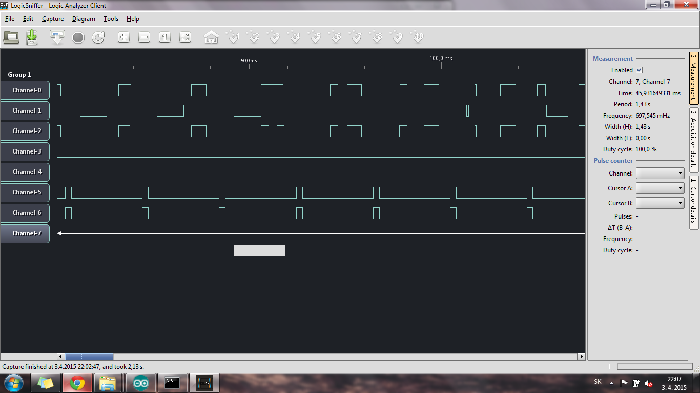

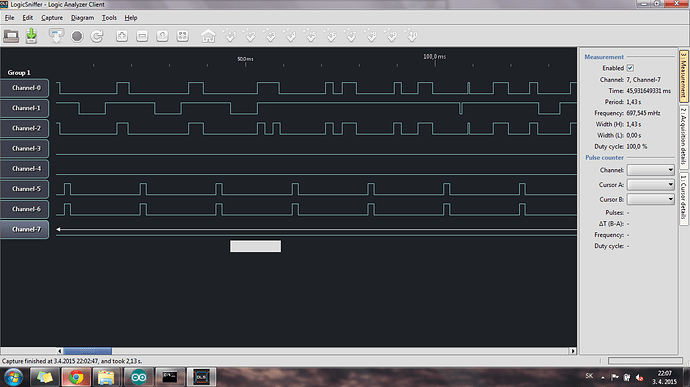

Hi, I spent two days searching for solution but no success at all. I´m trying to control brushless motor by esc, I simply want to read signal from receiver and write same signal to flight controller..I will manipulate it later. I tried to measure pwm signal by pulseIn and by interrupt too and use analogwrite to send it back to esc. After many experiments i started to doubt if signal really is pwm so I tried logic analyzer, look at printscreen. If somebody can tell what type of signal it is on channel 1 and whats going on with motor showed on video.
Channels 5 and 6 are the only valid servo signals in that trace. Video doesn't work for me.

Thanks for answers guys. I forget to mention that i tried servo library but still nothing. Believe me I go through lot of examples. I use frsky d8II-plus, manual on page is not helping very much. Is it possible that esc are reading ppm signal instead of pwm? On video you will see how motor work, its constantly arming disarming and working for a while.
