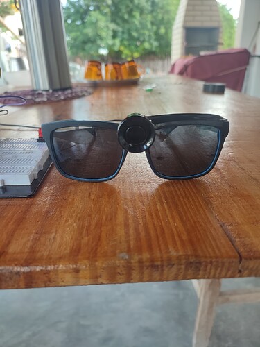

The second problem would be related to the ultrasonic sensor, as I want one to put on my glasses, I wanted something more discreet but all the ones I saw on the internet are very large and not at all discreet, I wanted something that would look nice on the armor of the glasses, can you tell me someone or help me reduce mine (if you can disassemble it or something)

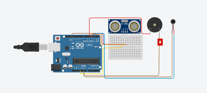

The third and final problem is related to the code, every time there is an object at a distance of less than 100 centimeters from my ultrasonic sensor, a buzzer and a vibrator start to work sending a 1 second pulse to each of them at the same time, however my code is only working with the buzzer, my vibrator is not working, I did a simulation in thinkercad so you can see how it is and so that you can help me with my problem. I'm new to this world of Arduino programming and I don't understand much, so I ask for your understanding for silly errors, but this is my current code below:

}digite ou cole o código aqui

Probably due to the batt... you should not connect a motor directly to the Arduino.

In this regard I was referring to the sensor on the glasses because currently it is right in the middle of the glasses, I will show you a photo
I didn't know that I couldn't connect the motor directly to the Arduino, thank you, I'll make this change!
