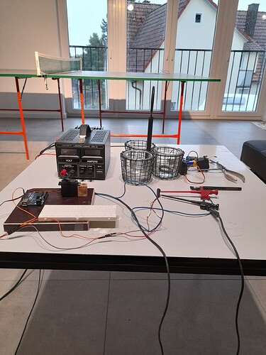

I am trying to build a robotic arm as a small project because I am new to this whole thing.
For starters I took the servo motor MG996R (what maybe was a mistake ) and ran into problems pretty quick. When I load the code that i used for the SG90 motors the motor, it just does weird things.
I figured it had something to do with the power supply of the motor because it still was getting its current from the Arduino 5V pin itself and that there might not have been enough Ampere etc..
When I connected it to another Power supply that I can change like i want I put it around 6-7V. But when I did that the wire got hot and there still was no sign of correct movements.
So whats the Problem here, do I need to buy better cables for these Servos to work?
And how do I provide a power source for multiple of these at the same time ? Are there any good and easy options to power multiple servos at the same time ?

Mostly likely you have an inadequate power supply. For that servo, you need a separate power supply capable of providing at least 3 Amperes. A 4xAA battery pack with fresh or fully charged cells will work for a short while.
Don't forget to connect the grounds.

The picture of the wiring is attached.

My power supply should be fine I still think it is the wires that create the problems.
I replied down below you can see the power supply etc there.
Wiring error, possibly damaging a number of components.
Don't try to use a breadboard for motor currents, as the tracks will burn. Breadboards are for low power logic circuits.
I didnt use the Breadboard for these as it seemed pointless for that exact reason it was just there because I used it for a joystick sort of thing earlier.
So I may have damaged my servos ? Hm that sucks but whatever.
And the wirres itself cannot lead to a Problem ?
Of course they can. You need to use a wire gauge that supports the expected current draw.

There needs to be a wire from the Arduino GND pin to the servo power-supply GND.
Pen and paper usually works well. Then a camera and posting the picture here.
Never power any motor from any Arduino pin. The tiny strips on the board are not designed for that. They might even fuse.

The control signal that goes out of the Arduino needs to return to the Arduino.
If you connect the signal wire (control wire) to the servo you need a return GND wire from the servo to the Arduino.
Oh that makes sense. Maybe this also was one of the reasons for the lack of control.
Most definitely.
Thanks alot I will try that.
How would you wire that ? If you look at the picture I dont really know how to get a second wire connected to the GND of the Power Supply
