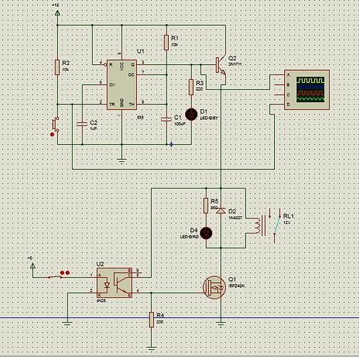

I'm doing an access control system, I'm having a little problem with the start button.
For the implementation of the system, I put the output button between the voltage source and the electromagnetic lock (view image). The button is normally closed (NC) when pressing the button the electromagnetic lock is turned off and the door is opened (in theory). But in practice it is not so, because the lock has to be unloaded. When the user presses the button, the electromagnetic lock is not discharged in that time interval, so the door is still closed.
In order for the electromagnetic lock to fully discharge the user has to hold the exit button pressed, the problem here is that when the button is released the electromagnetic lock is energized again and as a consequence the user will not be able to leave because the door is closed.
So I'm thinking of putting the start button as the arduino's input.
The problem of putting the output button on the arduino, is that the arduino freezes when it passes a "switch" instruction. So if at any moment a user or intruder accesses a menu and someone wants to leave the place, it can not leave because the arduino is waiting for the user or intruder to press a button on the keyboard.(Attached code) In the code, I made a interruption but it does not work when the program is in the menu. Because it is waiting for the user to press a key.
It is important that the people who are inside the place can leave at any time.
Someone to help me please?

You just need a simple 2 - 3 second off delay circuit, you could do that with a 555 timer and not even involve the Arduino.
outsider:

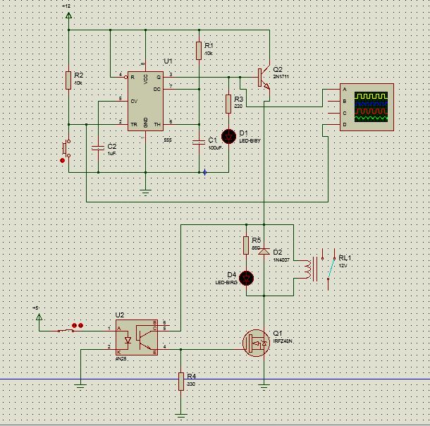

I'm trying to do that, with timer 555 in monostable mode, but I do not know how to generate a 5-second delay for the electromagnetic lock to turn off during that time period.
I did the proteus simulation.
Ideal function:
The output button is normally closed, so the electromagnetic lock will always be on, when the output button is pressed it stops feeding the electromagnetic lock for 5 seconds and then turns on the electromagnetic lock again.
My design:
It does not work that way because if I put a normally closed button the electromangetic lock is always on when the button is pressed. (view image diagram)
And if I put a button normally open, at the moment of being pressed the button the electromagnetic lock will be on for a period of time and then turned off. That's because the signal is square. (view image 555)
If anyone can help me, it will be very helpful. Thank you
