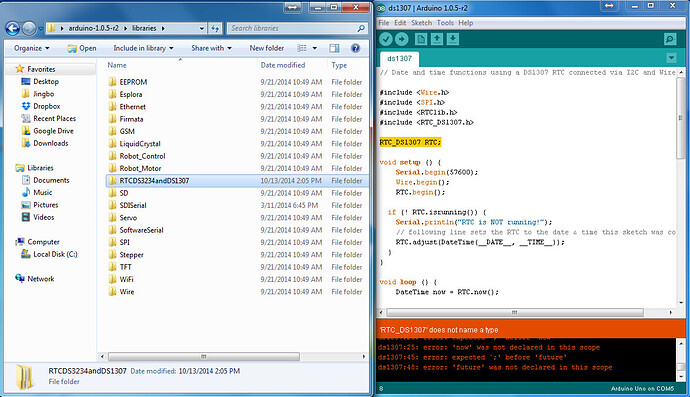

Hi, I've also tested the example of DS1307 and DS3234. Before I tested them, I put the file in my arduino libraries. the example still did work. you can check the picture I attached.
Those are the system files of Arduino with the default libraries. So that is what all the confusion is about.
Go to the settings of the Arduino IDE: File / Preferences.
Look at the location of your projects : "Sketchbook location:".
It might be something like this: C:\Users<user>\Documents\Arduino
Go to that folder.
There you see the folder of your projects. One of them is called 'libraries'.
And that is the 'libraries' folder for downloaded extra libraries. That is where it should be.
In the Arduino IDE, select "Sketch" / "Import Library..." / "Add Library...". Select the zip-file and it will be installed in that 'libraries' folder next to your projects.
When the Arduino IDE is updated to a new version, your project files and your downloaded libraries stay the same. So it makes sense :slight_smile: But perhaps the system libraries folder should be called "syslibs" or so.
Don't forget to remove it from the system libraries. Or perhaps download the Arduino IDE again to be sure that the Arduino system files are in their original state.
