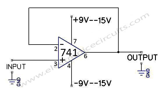

Must dual power op amps don't have a GND pin.
Oh. OK, I'm connecting VCC- to GND because I'm using them just with positive voltage.

Like this.
yes, that's a non-inverting buffer, right?
I have one of those just after my R2R dac, the only difference is that I'm connecting pin 4 to GND and pin 7 to +12.
