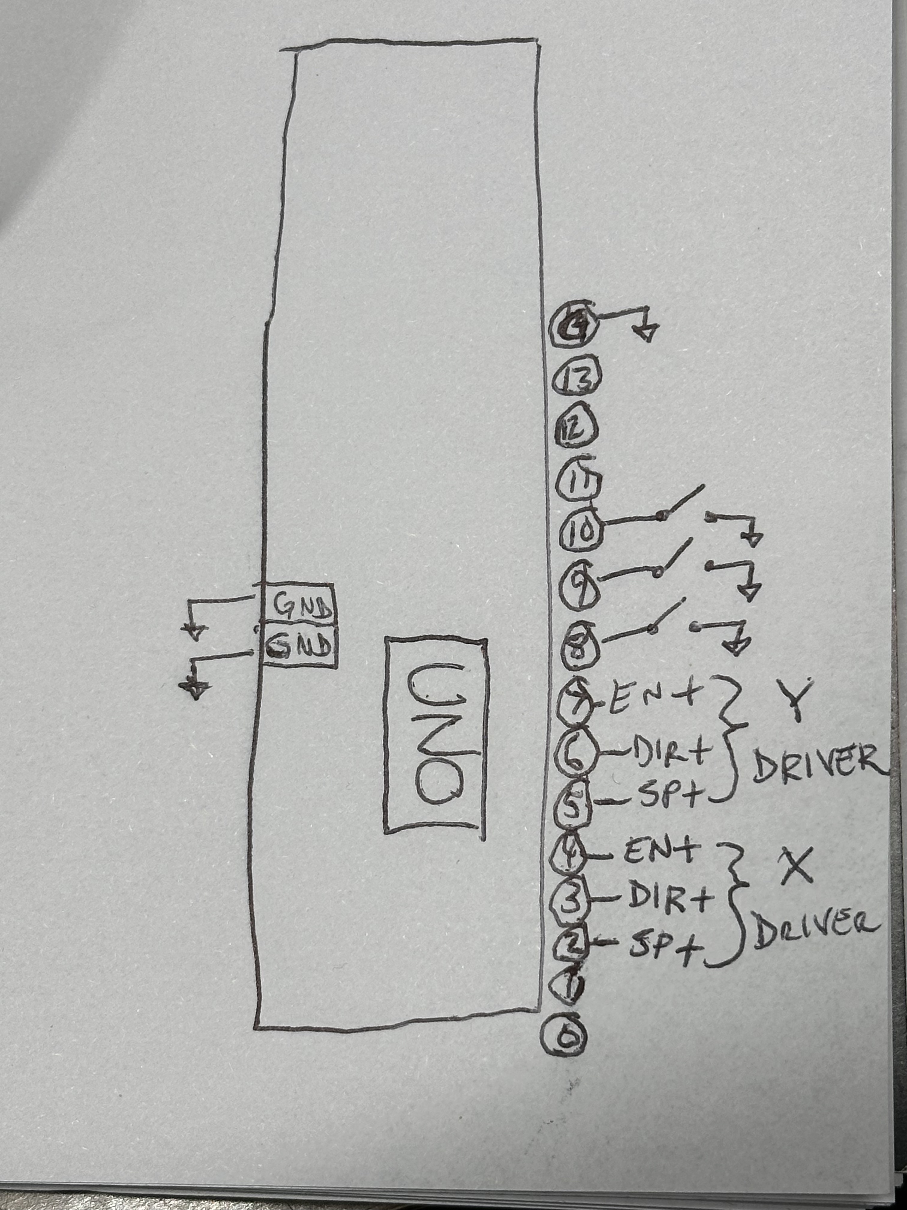

Program for coil winder, buttons work normal first time but do nothing the second time pressed. Arduino UNO
Hi. I made a coil winder with a x axis stepper motor turning a ball screw linear stage to move a wire guide left and right. The Y axis is a motor that spins a bobbin on its shaft. The X moves the wire back and forth while the Y axis spins the bobbin. The X axis homes when powered up as it should. The buttons, buttonPin and buttonPin2, work as they should but one time only. After that the buttons do nothing when pushed. I have set the layers to low numbers for quick testing. There are no errors when verifying. I’m not sure if I’m over looking something or maybe I have somehow messed up my Arduino UNO. Any help would be appreciated.
// Coil Winder Sketch 39 AWG, 150 winds per layer. 1:10 ratio, 1:1:10 ratio.

I can't say it' related to your issue but both Buttonloops can invoke recursion.  Recursion has its uses but one must be very careful about it.  I'd start with rewriting the functions to be non-recursive.
Kudos for code and a schematic in your first post.
What is the sequence of operation? What function do button1 and button2 have? I assume a limit switches for the X motor? How are your buttons wired? How is the homeswitch wired? Limit (home) switches are usually on (make) until home (break)... so for your INPUT_PULLUP switches, that is LOW (motor moves) until HIGH (motor stops).
Which state is which direction?
Sequence
First, the homing of the X axis works fine no problem. The wire guide moves to the right till it trips the homeSwitch, changes direction moving to the left at a much slower speed, stops when the homeSwitch un-trips, and calls the function ButtonloopA().
ButtonloopA() loops until buttonPin or buttonPin2 is pushed.
Buttonpin calls the function MotorloopA() which moves the wire guide to the left while the Y axis rotates 15 times then calls function MotorloopB(). MotorloopB moves the wire guide to the right while the Y axis rotates 15 times then calls function MotorloopA(). Each time the X axis changes direction is considered a layer. When LayersTotal = 5 the function ButtonloopB() is called and winding is paused. At this point the buttonPin button can be pushed again and nothing will happen but buttonPin2 can be pushed and function MotorMainLoopA() is called and winding resumes. The main difference between buttonPin and buttonPin2 is buttonPin is LayersTotal = 5 and buttonPin2 is LayersTotal2 = 10. The functions called are different names but the results are the same moving the wire guide back and forth while spinning the Y axis and winding the coil.
The buttons are simple connected to ground. Push for LOW.
You don't seem to appreciate the problem @dougp points out which is recursion. It is not useful here and is in fact just plain a Bad Thing.
"Keep checking buttonPin and buttonPin2 until one of them does something."

I think that amounts to the same thing and is free of recursion.
You have to fix any function that calls itself.
a7
I was just reading the link @dougp posted about recursion and trying to understand how that could cause me problems. I see that it could be problematic but not necessarily.
I see your example completely removes the calling of the function from within itself. I will also look into your example to understand it.

Your code is too complicated. Simplify it to this:
  1. X motor "homes"
  2. Y spool motor steps forward three times for every one step of the X (lateral) motor.
  3. When lateral motor X hits an edge, it changes direction
  4. You either want 5, 10 or 15 changes of direction... keep track of layers.

@xfpd It seems the homing is not operating correctly with your code. The stepper motor just makes a hum but does not move. I am studying this more.
All I got at the moment is to suggest to you to add
to the setup() function, and add Serial.print() and println() statements to check the values of key variables and confirm that they are properly informing flow through your code.
Your spare description makes it sound like you are getting stuck somewhere.
You might be able to place a small delay on the loop to cut down on the output of such statements. Also it's fairly easy to make printing happen only when a variable has a new value rather than every time.
a7
Thanks. I will do this.
When you connect your wires according to the sketch, both will work.
I supplied the simulation setup for you to see and adjust as needed. (in the same post)
look this over

@alto777 The Debug Serial.print works well. The answer to my button problem was in the Motorloop() functions. Once the variable 'Layers' is no longer '< LayersTotal' it would skip all the motor functions and go back to the Buttonloop() function. So as long as the button was pushed it would loop from Motorloop() to Buttonloop() over and over.
The solution is
if (digitalRead(buttonPin) == LOW) {
      Layers = 0;
      MotorloopA();
That reset the variable 'Layers' back to '0' after each of the buttons is pushed allowing the motor functions to be called.
Thanks
@xfpd It seems I had wired the home switch opposite of my schematic. I moved a wire on the home switch from connector 1 to 2 and the program works. The code will need some tweaking to do exactly what I need but I like the way it is written. I will be studying this more.
Thanks
@gcjr I will be looking over this code too. So many different ways to program to get the same results. Lots to learn.
Thanks
