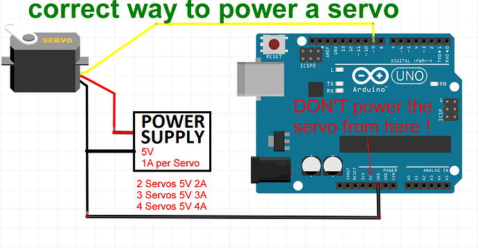

Hi all, I am using the nano board to operate a SG90 micro servo. I am using a 5v supply at 2 amps. I have plugged the 5v line directly into the 5v pin. Power to the servo is separate and not from the board.
I have a program on the nano to run the servo. Nothing was happening. The servo was not moving. When I plugged in the nano to the usb port on my computer the servo started moving according to the programmed instructions. When disconnected from the usb the servo continued to work as programmed.
What would be the explanation for this? I am thinking that when I plugged in the usb the program ran through set up. In the void loop the set up instructions were being ignored for some reason?
But you have to connect GND between the power-supplies.
It might be that using the USB-cable made a GND connection on this path
protective-wire in the main-socket1----your Computers-protective-wire-----------USB-Shielding-------Arduino-nano----GND------------------------------------------------------------------------------------.......
.......------------------------ Protective-wire in the main-socket2---your power-supply-protection-wire--------GND-of-power-supply
I am not powering the servo from the 5v output of the nano board. My connections are exactly as shown in your schematic. The ground connection to the power supply and board are the same.
So this still doesn't explain why the servo was not working and program running until I plugged in the computer usb port to the board. I plugged in and then removed the connection and the program was running as designed to run.
Then I still don't understand why this was necessary.
