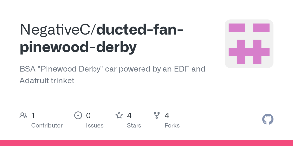

Building an outlaw EDF pinewood derby car has gotten my son and I into programming. I am new to programming, learning from online videos and forums. So for my car I am using a code already written for the same application. Original programing was for an Arduino Trinket and I have a Nano Every. I've made adjustments accordingly.
The program seems to be running but the 20amp BEC ESC that controls the Ducted fan is not arming and I'm not quite sure how to program it. I've been looking at the manual but I'm not sure what to do.
I appreciate any help. I'll answer any questions you have as well. I'll share my program, the ESC manual and the original program for reference. Thanks!
ESC Manual
Original Code
My Code
