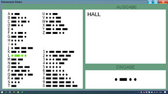

Now I need to ditch the serial monitor-approach (since it's not practical enough) and provide him with a proper windows program which displays the morse alphabet on the left and the Arduinos input on the right-hand side.
This would enable him to see the morse-alphabet, put in the needed combination of code and see the corresponding letter simultaneously appear on the right-hand side of the display.
He needs the program to be able to practise and train his muscles.
In time the error rate will go down and we can move onto scrolling devices and the like but for now we'd need something like this:
The program would differentiate short and long pauses between signals, either starting a new letter or a new word.
Essentially I need almost exactly what Vladimir Krsmanovic' sketch is already doing but I need it displayed in a graphic interface!

Hi @fintopolis, great project!
The choice of language usually depends on the pre- knowledge:
If it is C++ Microsoft Visual Studio C++ could be a good tool.
If it is Delphi/FreePascal Lazarus is easy to handle.
And there's also Python available.
All these languages do have libraries for serial communication that can interface with the Arduino, read, display and evaluate the data.
As mentioned by the other members already, you can also use the Arduino serial link to control an input array of characters without complete Morse coding, e.g. by using different, easy to learn codes for left, right, up, down, enter and delete... You could even couple it with a library of words to speed up inputs ...
