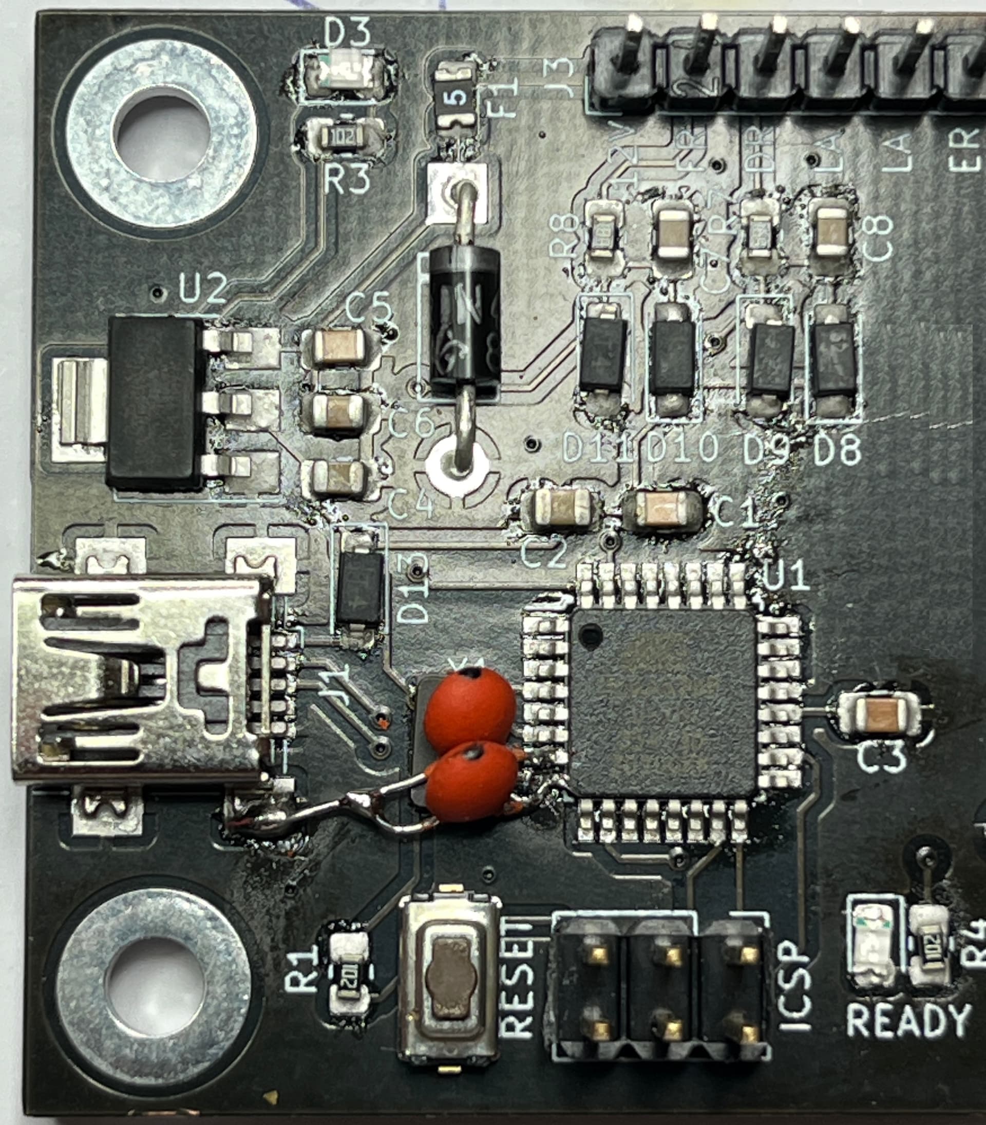

I have developed a board with an ATMEGA328P on it and I am planning to run it as a classic Arduino Nano (a nano embedded in my own board). I have used an Arduino Uno to program the bootloader on it, but the external 16MHz oscillator does not seem to start when I check it with an oscilloscope.
The programming of the bootloader went fine (it writes and reads back everything):

Since the oscilator does not seem to be running, I suspect that I have one of the following problems:
The fuses aren't set correctly (although the avrdude logging above seems to indicate that it is setting fuses, and since I replicated the Nano schematic, I assumed that it would set the fuses to use the external oscillator.
The oscillator itself is not the correct make/model and the atmega can't get it to oscillate
I am wondering what the next smart step is in analyzing this problem, before ripping off the oscilllator and replacing it with one off of an original Arduino Nano board.
Please note that on the schematic I was missing the 22pF capacitors (doh!) and I had to add them later, so it doesn't look all that great. The next revision of the board will get the capacitors, but not before I figure out why the oscillator doesn't start.
I have verified that the pins aren't shorted, and the 16MHz resonator that is hidden underneath the capacitors is a 16.000Mhz 5032 Smd Quartz Resonator like this one:
If someone can confirm that the bootloader burning process is indeed setting the fuses correclty for the external 16MHz resonator, I think I need to re-do that circuit (first the experimantal way of course )
I doubt that the fuses are set correctly, but I don't use that method of programming (I use a commercial programmer with Atmel/Microchip Studio). You need to read out all the fuses and check them.
If they were not set correctly, the chip will still be running on the internal 8 MHz RC oscillator, with the CKDIV8 fuse set, for 1 MHz clock frequency.
There are instructions somewhere on line for reading/writing fuses, using the setup you have.

This should enable the 328p to use the external 16MHz chrystal oscillator. In my case it does not start, so I am now planning to replace that oscillator with another model.
If the oscillator wasn't starting, you wouldn't be able to read the fuses.
This is the number one way to "brick" an AVR chip - the clock is needed for ISP programming, so if you set the fuses to a value so that the clock requires a crystal that isn't there, the chip appears to go completely dead. (it can be revived by injecting a clock.)
The 1k pull up resistor on the reset pin looks rather strong. Usual is 10k.
If it still does not allow you to upload code via the FTDI circuit, verify the connections. Maybe also add a led to pin D13 (SCK broken out on the ICSP header) to see some bootloader activity.
One classic error is overwriting the bootloader by attempting to upload a sketch with the the ICSP programmer still attached.
Interesting. So the fuses are set for external clock but when I use an oscilloscope to check the clock it is not oscillating. Judging above answers, it should either be oscillating, but the probe capacitor makes it stop, or it is using the internal oscillator.
