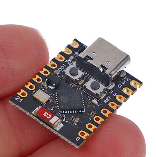

Until you get more familiar with Esp, you could try with more compact dev board like "super mini".
