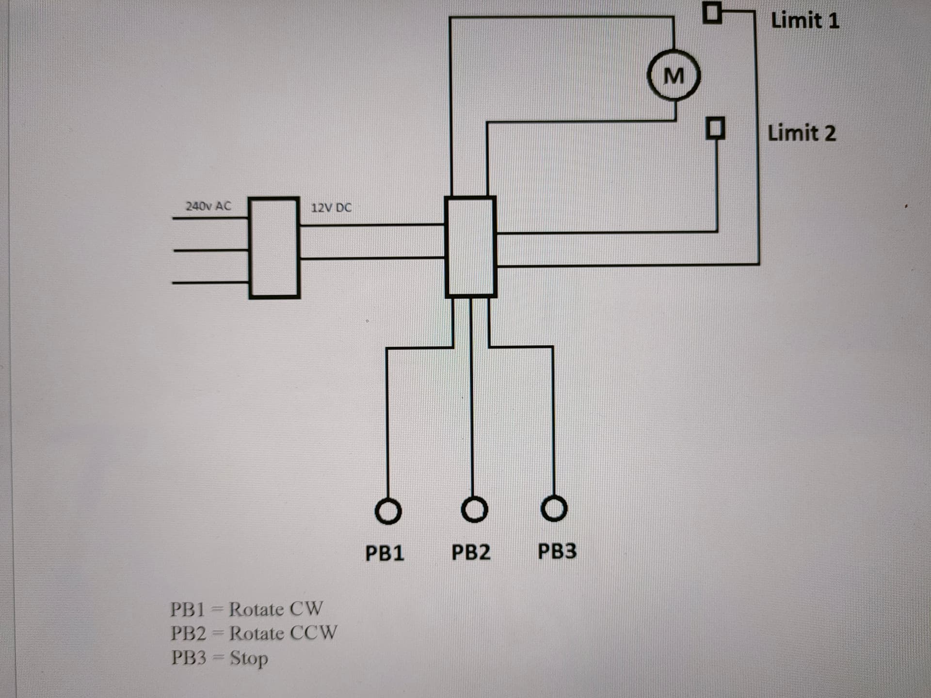

Apologies for the poor description of the problem, hopefully I have explained it better below.
I am currently using ARDUINO UNO. yes this is a simulator code. I have attached photo below.

A servo is sent a value and will try to torque to that value. A limit switch can send a signal to the MCU that the servo has reach such and such a position, but the servo will still attempt to keep driving to the programmed position. How are the limit switches expected to work?
Will the limit switches remove servo power? If servo power is removed how will the servo then be driven back to it's 'normal' postion?

Those servos are getting their power from the Uno?

You are using 12V servo's?
No, 5V

Servos go to a commanded position and then stop, don't send the servo to a position beyond where you want it to go.
Your image from post#11 shows motors being run from 12 V. Not the way to do a servo.

the limit switches are supposed to act as a safety feature if the servo goes over its end position

Shannon I think i get wat you are saying, i will needed to set the limit switches either side before the servo reaches its limit as a safety mechanism.
