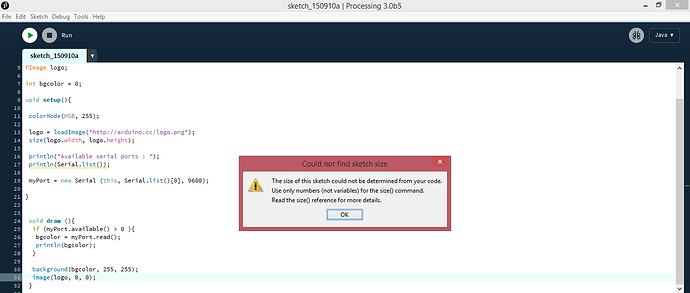

when I start doing the project 14 I have faced a problem, after I have wrote my codes therewas an error in the processing program say as the Pic .
so what I should do ?

here :
size(logo.width, logo.height);
use numbers instead of variables, like the error says, like
size(200, 100);
I’ve just tried it yesterday. Besides the size that “RajoAlfa” mentioned above.
Please modify this line as well:
myPort = new Serial(this, Serial.list()[0], 9600);
to
myPort = new Serial(this, “COM3”, 9600);
Note: COM3 is what my Arduino using.
It works for me!! :slight_smile:
I am using OS X 10.11.1.
