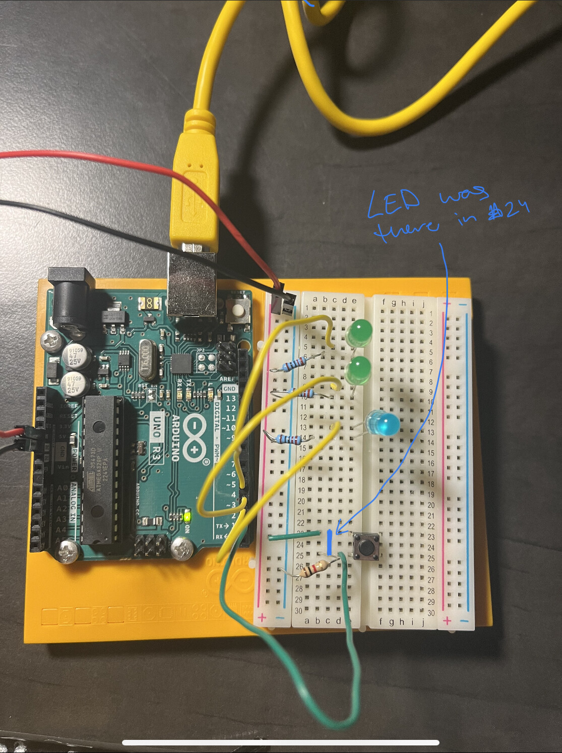

Would you show (drawing, picture) how you connected the LED to the button in post #24?
Yes
With the LED bridging rows 23 and 25, and forward biased, shows the power and ground paths were good to the button. The LED turning off meant the potential difference of + to - was zero, so no forward bias, and no lighting (meaning: the button press worked).

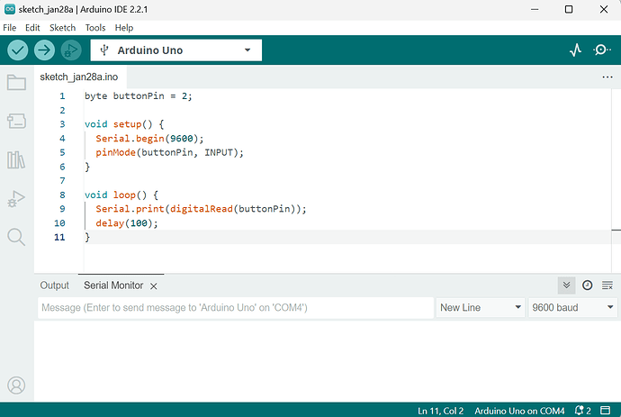

With your project connections "normal"... copy this code, verify and upload it... press the button, and look at the Serial Monitor... what do you see?
byte buttonPin = 2;
  pinMode(buttonPin, INPUT);
  Serial.print(digitalRead(buttonPin));
  delay(100);
I don't really understand this or know what I'm looking for but here's what I did. What button am I supposed to press?
After you upload your sketch (the -> arrow), You will see the Serial Monitor (bottom part of screen) become active. You should then press the button on your breadboard. While holding the button, look at the Serial Monitor again. What did you see before the button press, and during the button press, and after the button press.
I didn't see anything during any of the stages.

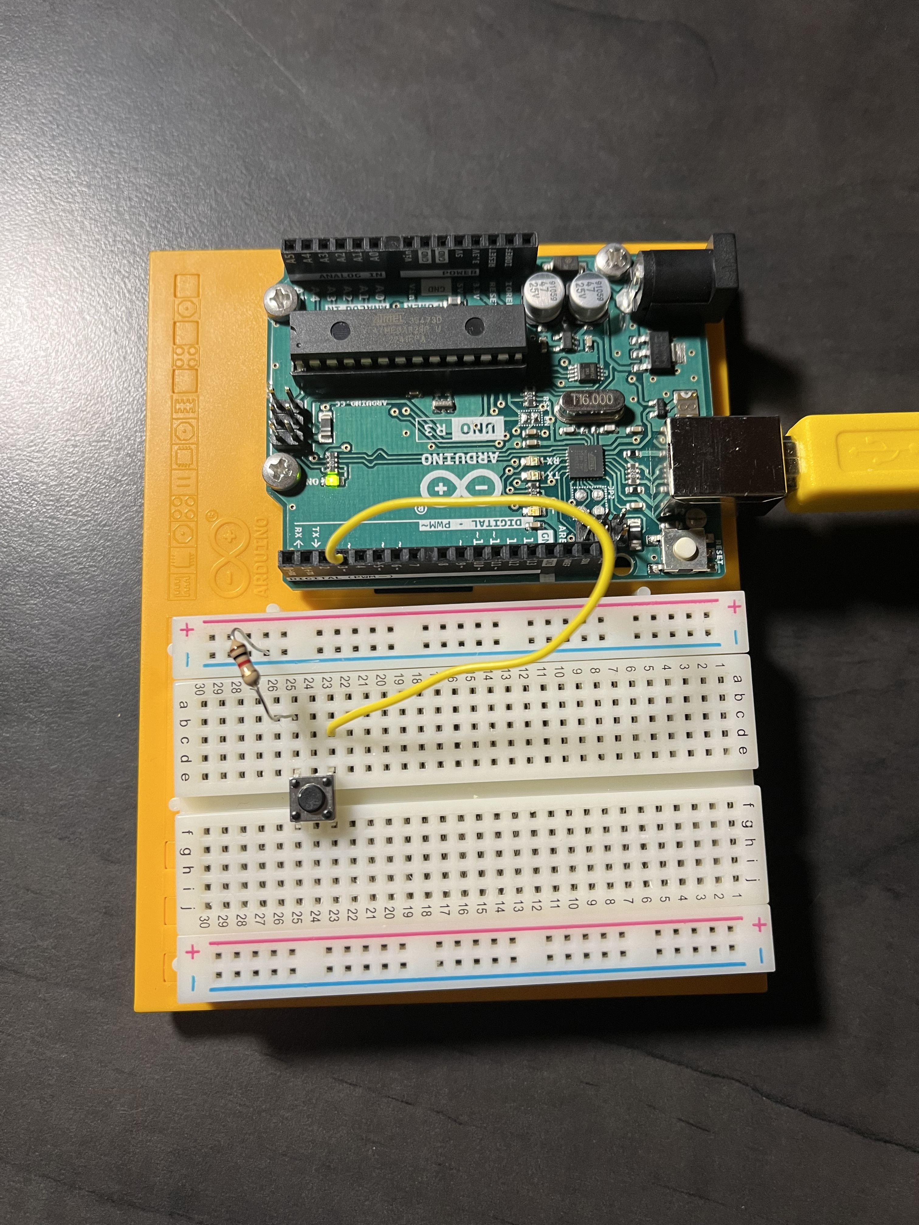

To connect the button to the pins should I run a wire from the pins to row 23 or to row 25?
  1. Remove the green wire coming from Pin 2 at the button
  2. Move the yellow wire coming from Pin 3 and connecting to an LED, to the button where the green wire was inserted at the button.
  3. Test Pin 3 using the code in Post #36.
  4. Repeat step #2 and #3 with Pin 4 and then Pin 5
I tried with all the pins, none of them caused any 0s or 1s.
Remove all wires from the Arduino, and run the same test.
Like this? Because that’s still giving me nothing.
