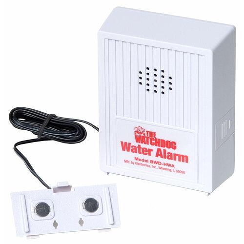

Hi, we are a small volunteer fire department and have an area subject to flash floods. We would like a circuit attached to a water sensor and a 12v car battery that would activate a siren to warn home owners. Is there an Ardunio circuit for this? Any help would be appreciated.

Then why do you include an Arduino????
A float switch connected between the battery and the siren is all you need.

I don't know, the float switch sounds best to me. If you hook it up to an Arduino or ESP you could send out emails or SMS instead of siren or in conjunction with a siren.
This does exactly what you want - and a lot more, and while the base unit sends a text message or flashes the strobe, it can be rewired to switch anything with the internal relay contacts.

if the flood warning is for water that is 1 foot above the normal level, you could easily build a cement box with sensors inside. pretty much just a plastic coffee can with concrete around it and open for water to enter. From videos of flash floods, they are as simple as a gentle rise in water level to a wall of water that collects cars and carries them away.
This would seen like a very simple project
solar panel, battery, float switch and a siren at the simplest
two wires can detect water as shown and used and there are lots available at your local hardware store.
distance from the place you want to alarm is where the Arduino comes in.
a simple sensor can be connected to a LoRa or WiFi and each station up the line can alert the next station.
It would not be hard to burry half of a cement block (cinder block) and use the open section to hold the sensors.
screens to let water in and keep animals out.
