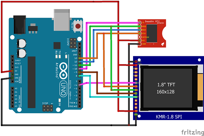

Projecting RTC DS3234 data to TFT display
I am using an Arduino Uno R3, DS3234 RTC and TFT display (KMR-1.8 SPI). The schematic looks like this.
I have tested the RTC and TFT using separate sketches and they work fine.

PS: I am new to Arduino and programming. Kindly bear with me if there is a blatant mistake.
Move datestring so it is global. Print that to your screen. Untested:
char datestring[20];  // global now…
RtcDateTime now = Rtc.GetDateTime();
printDateTime(now);
Serial.println();
myscreen.stroke(255, 255, 255);
myscreen.text(datestring, 10, 30);  // print the nice datestring to screen
myscreen.stroke(0, 0, 0);
myscreen.text(datestring, 10, 30);  // datestring again here

Thank you so much for the reply. It worked. Just one more question. The below code under void loop prints the date and time and after 1 second delay erases it and prints the new time.
This method gives a flickering effect on the entire date and time when the second changes. Is there a way to avoid this flickering so that the time updates in a smooth way?
Not really, but you can do the erase thing very immediately before the new time thing, so a few things that are now between, and take some time, aren't and therefor won't, viz:
