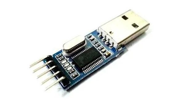

So i had a a broken Arduino (original) that its comm. chip was broken so i took out the 328pu and bought a prolific pl2303 to program it but for some reason there's no dang DTR/RST/RTS pin and when i press the reset button myself, it doesn't work either it just ives stk500: 1 out of 10 resp 0x20 or sum, so what's the problem?

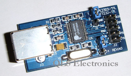

Your PL2303 is like this : ?
Or This:?

let me send you link Prolific PL2303 USB-TTL Seri Dönüştürücü Kartı Satın Al | Robotistan

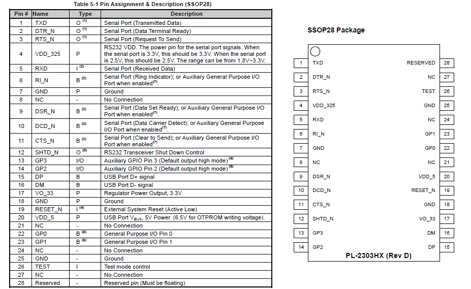

It looks like DTR is available on/from the IC. Perhaps you could route it out. It's a Fine-pitch job for sure.
Your module model does not have DTR/RTS pins available externally,
but if you are skilled you can connect wires to the IC pins.
See the drawing and description of the IC pins.
DTR pin 2
RTS pin 3
