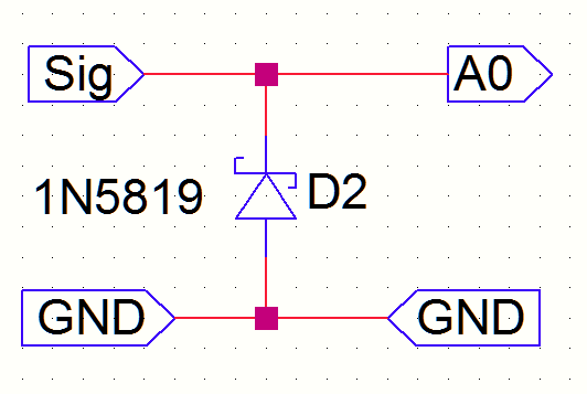

Ok thanks, so I will do the diagram @jim-p sent, adding a 1Megohm load across the piezo; but maybe with 1N4148 diode rather than the 1N5819 Schottky diode mentioned ?
As for the magnetometers, can I do the same (but excluding the top part as I only ned negative clipping)?
No, must use 1N5819
That circuit will clip the negative voltages.
If you need the negative voltages then a different circuit is needed

Use this circuit::
Piezo :

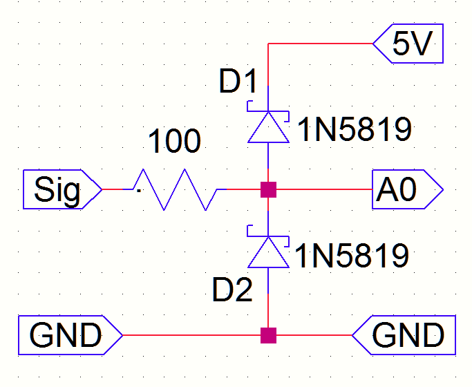

If the signal range is only +/-2.4V, then all you need is this:

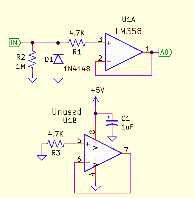

For the piezo input, this is the best way but involves a few more parts
Thx but I feel like this would be a bit overkill for a piezo no, like the circuit you showed before (see quote) seems enough ?
Well if you add two more resistors to that circuit you can have gain. Amplify your 500mV signal to around 3V.
If you use the 2 diode circuit then as @Wawa pointed out you will need to use 1N4148 diodes and a 1K resistor
