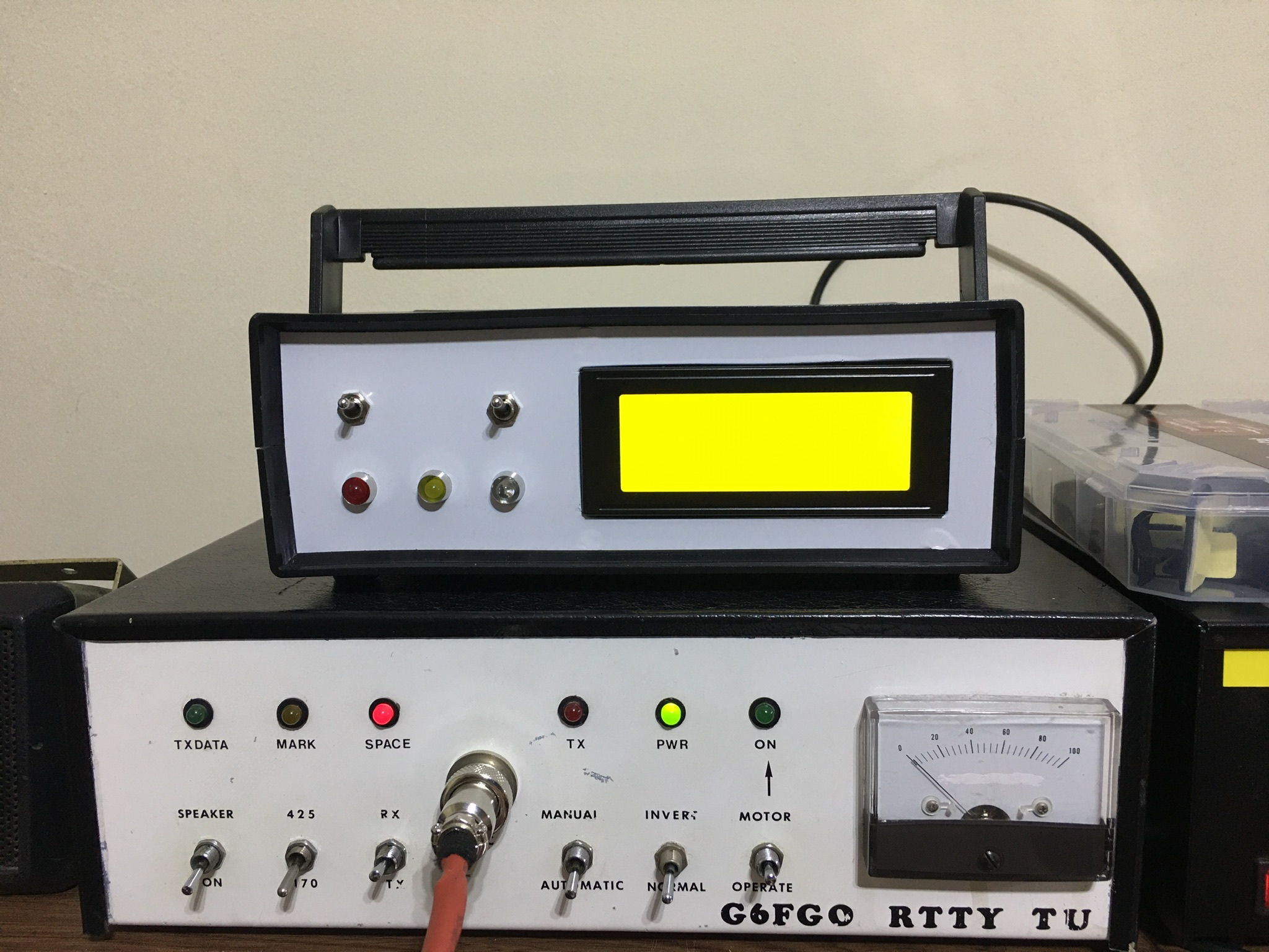

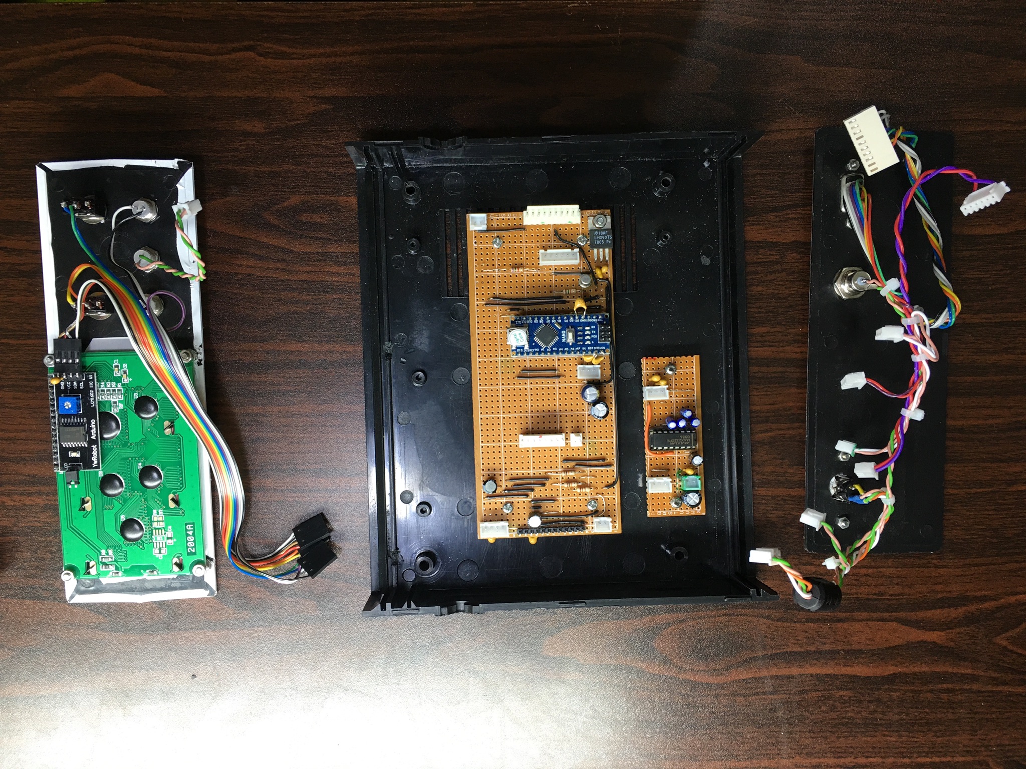

A couple more (this is hard work on an iPad!)...
Heh, HAM still use RTTY these days?
Radio Amateurs do, but no idea what pieces of meat do. :wink:
That is what the unit is for until I can find another teleprinter. This is an electronic version of one. It accepts a PS/2 keyboard for transmit. Still lots of mods to do to, it is quite basic currently although useable.

Just a quick lash up really.

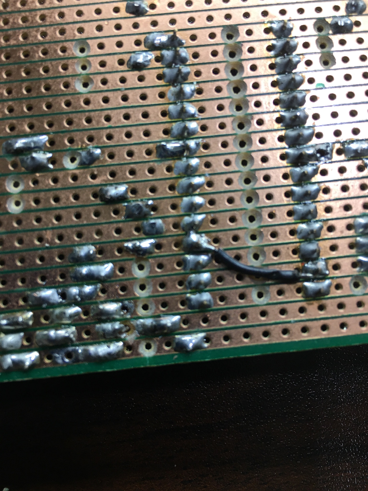

"For connections to the Nano do you have wires running as vias on the other side of the perf board?"
Have you not come across stripboard before? The photo shows some after being badly soldered. In fact it is the reverse of the main board in the terminal unit I have just shown you. If you look carefully you might be able to see why it didn't work first time!
"What are some good sources for ribbon cable like that? (I'm in US)"
It must be simple to find, just do a search for ribbon cable.
"Do you crimp your own connectors onto the ribbon cable?"
Yes, you should maybe look for a kit. I have bought a Preciva crimp tool and assorted connectors. Try a search for that. It also comes with some pretty ribbon!

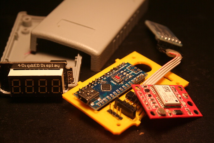

Here's a pic of my project. Far fewer components than the ones above.
The 3D printed board is an advance on a breadboard, but not as polished as a custom PCB. Connections under the board are by hookup wire. The board (yellow) fits just right into the grey box. It took much effort to squeeze it all into th ebox, but the end result will be good.
I swear bad connections are the greatest time wasters. I'm still an amateur at this.

John, thanks for your insights.
I found jumpers introduce a voltage drop that ruins the GPs performance.
That's really odd. I haven't had any of these problems. I have 5.08V on the + side of the Apple USB charger, and it only drops to 5.06V on the VCC pin on my GPS module. (I'm powering directly and not via the nano.) I've found the genuine OEM Apple USB charging brick is rock solid.
I'm embedding headers in the board and connecting display and GPS and Bluetooth to the headers with ribbon cable.
How are you connecting the ribbon cable to your headers? Are you doing your own connectors with a crimp tool or some other approach?

It's good that your are monitoring the volts at the GPS module. I found 4.8V is the level at which the module under performs. If you've got 5V then that shud be ok. If the GPs output is steady then it's ok.
I found the 5V pin on the Nano (non genuine) is more like 4.8V, so I power the GPS directly from a power bank.
I solder the ribbon cable wires to header pins. The header then connects with a complimentary header embedded in the board. I strengthen the ribbon cable with glue. I still get flaky connections.
