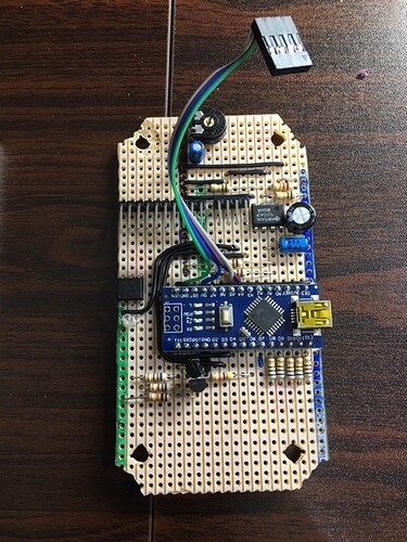

The underside after installing hookup wires. My soldering isn't pretty.
Most of the difficulty in making things neat is your poor choice in hookup wire. That looks like perhaps 20 gauge thermostat wire, far bigger than it needs to be, that stuff is miserable to work with on a good day. Proper tinned 26,28 and even 30 gauge solid hookup wire is more appropriate for point to point wiring such as you’re doing.
30 gauge “wire wrap” wire is available for cheap on eBay, 1000 foot spools for less than $10. It’s not proper wire for real wire wrapping as it has pvc insulation but it’s perfect as logic hookup wire, besides, no one really does true wire wrapping these days. Well, almost no one.

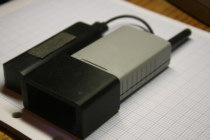

Completed board with components installed; 3D printed end plate; all fitted into shop-bought housing:
Finished gadget:
view of end plate; HC-05 Bluetooth module inserted:
device in operation; 3D printed hood to shade display:
