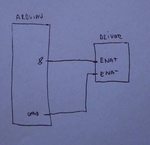

I'd like to ask your advice. I need to use an arduino to control a stepper motor driver.
(http://www.leadshine.com/productdetail.aspx?type=products&category=stepper-products&producttype=stepper-drives&subtype=general-stepper-drives&series=em&model=em806)
In short, the driver has 6 inputs
ENA +/- (enable)
DIR +/- (direction)
PUL +/- (pulse)
which I would like to control with the outputs of the Arduino NANO (precision clone):
ENA-, DIR-, PUL- directly to the GND of the arduino
ENA+, DIR+, PUL+ directly to the digital outputs of the arduino.
And now a question:
As I read, the digital inputs/outputs of the Arduino are set as inputs by default during power-up, restart,... And if I understand correctly, the driver inputs would take it as if they were at HIGH level at this point.
Sure, I can immediately override settings of the the PINs within setup() (I know that it's possible to use writeDigital LOW before setting the PIN as output, etc), but my concern is the moment before setup() is even called. I need the PINS to be there during arduino start, restart,... for the driver at LOW level.
Is the correct solution to connect the arduino pins directly to the corresponding "+" inputs of the driver, but also connect each of these arduino pins to GND via a pull_down resistor (some 10k)?
(example for ENA+/-)
Thank you very much for confirming this idea....
P.S. this is my first project with arduino...

And this will guarantee that even during arduino start and arduino restart the ENA+ input of the driver will be always on the LOW level even with this connection? (example for ENA+/- inputs)
You don't need any pull-down resistors. The stepper driver has optocoupler inputs, so the arduino only controls one LED per driver input. is absolutely problem-free, even during the startup / power on of the arduino.
That makes sense, thank you!
Just for completeness: Yes, pull up/down resistors can be used to keep pins at high/low level on Reset.
