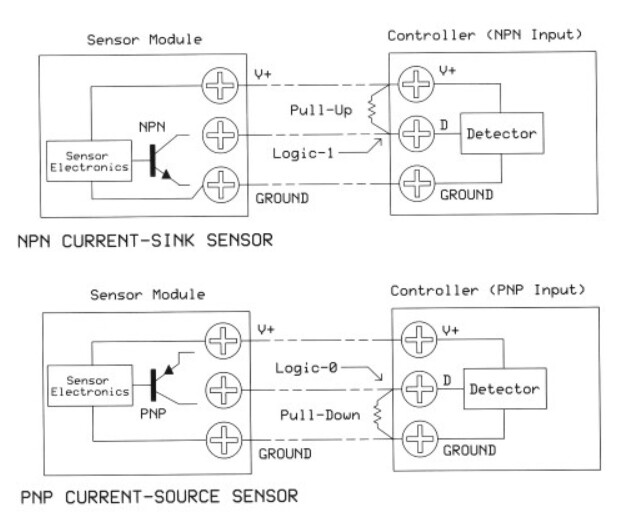

Hello everyone!
I'm trying to understand the difference and if I should be using a pull-up or pull-down resistor with a PNP/NPN hall sensor.
Should I use pull-up with PNP and viceversa for NPN? or can I use pull-ups for both NPN and PNP and then, on the code where I have the attachToInterrupt section I change from "RISING/FALLING/CHANGING" depending if I used a pull-up or pull-down?
I'm doing a project for a Tachometer and I'm now choosing sensor and resistor to use, but without this basic knowledge I obv. cannot decide on what to purchase.
Many thanks for the help!
With PNP pull down and rising, with NPN pull up and falling
Simple trick assuming it is an open collector output. Look at the center letter of the transistor device and that tells you whether to pull it "N" negative or "Positive.
Hi, @francescoranchi
You need a pullup resistor for NPN transistor output.
You need a pulldown resistor for PNP transistor output
Ok super! many thanks, one last question, If I use for example NPN with pull-up and attachToInterrupt "FALLING" it must be a NO, otherwise if it's NC I need to write "RISING", is that correct?

Anyway there are 4 wire sensors that can be used NC or NO . They have 2x npn or 2x pnp incorporated.
Normal 3-wire PNP hall sensor is giving positive output in presence of magnetic field, so it's considered "NO"
Right :frowning:
Most probably that text was created by ChatGPT, you should not rely on it.
NPN and PNP act like mechanical switches, where NPN is tied to - (GND) and needs a pullup resistor, while PNP is tied to + (Vcc) and neads a pulldown resistor. NPN is the best choice with µC which have a negative common GND, so that the pullup can go to the controller Vcc regardless of the sensor operating voltage.. PNP sensors instead can have a high operating voltage that exceeds the acceptable controller input voltage and deserve further circuitry.
NO and NC should be known from relays or other mechanical switches. When activated then NC connects to - (GND) for NPN or to + for PNP. NO does the same in not activated state.
More properties are important with Hall sensors. You already seem to have decided for digital senors, not analog. Digital sensors can have a hysteresis and may latch. Latching means that one magnetic polarity turns the output ON and only the other polarity turns it OFF again.
