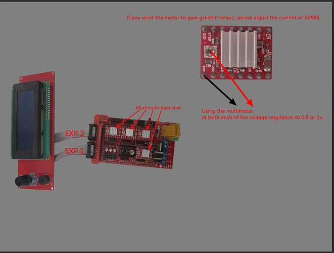

So right now i moved the components back to the Arduino Uno board and now everything spins, but i cant make it stop.
The connections that i used are the basic connections for a 3D printer using the Arduino mega and the Ramps 1.4, the drivers are pinned down to the Ramps and the ramps is connected to the arduino board.
I do not have the LCD display and i plugged the motor and driver in the E position and the powr supply is connected like in the photo (everything else was removed).
