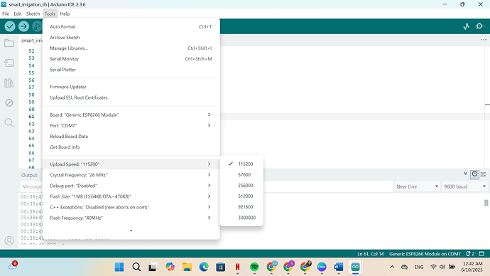

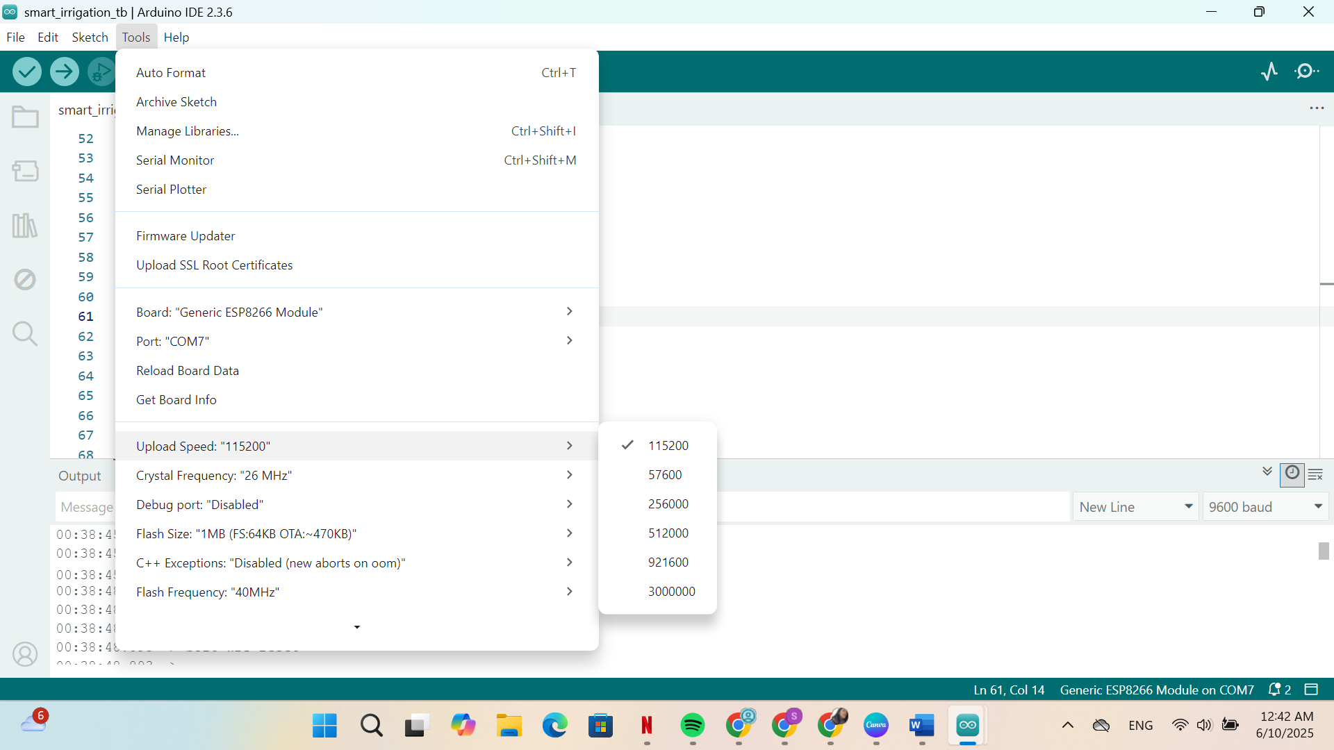

the wiring is done, but i have the problem into the serial monitor, i succesfully compile, but the serial monitor output like this
�����f��~����~~���f��xf���..................................................sdd��<�$�| �l�b|���e�r�c� c��oo�dno���cpx��dsl{${$$��|�l�| � d� c|����{�b�c��gn�lgg��� cpx��$sd{lsdd��|�l�| � d� c|����{�c�c��oo�dno���bxp��drl{d;ll��|�d�< �$� b|���e�r�c� c��oo�dno���c8x��dsl{$sdd��|�l�| � d� c|����{�c�c��no�l'o��� bxp��drl{d;llܞ|�d�| �l� b|���e�r�c� c��og�dno���b8p��drl{d;llܞ|�d�< �d� c|����{�c�c��no�l'n��� #xp��l;lsdsll��|�d�< �$� c|����{�b�c��'n�lg'��� cp8��${d;lrllܞ|�d�| � d� c|ǃ��s�#� b��g'�lgg��� cp8��$sd;lsdd��<�l�| � l�c|���e�r�c� c��oo�lno��� bxp��lrlsd{ll��|�l�| � d� c|ǃ��{�b�c��gn�lgg��� cpp��l{$rlsll��|�d�| �l�c|���e�s�c� #��gg�$gg��� cp8��l{d;lrllܞ|�d�< �d� c|����{�b�c��gn�lgg��� cp8��l{$rlrll��|�d�| �l�c|���e�r�c� c��og�doo���c8p��lrlsdsll��|�d�| �l�b|���e�;�c�c��no�l'o��� #xpćl{lsl{$d��|�l�| � d� c|����{�c�c��no�lno��� bxp��lrl{dsll��|�d�< �l�b|���e�s�c� c��og�doo���cpx��dsl{d{dd��|�l�| � l�b|���e�;�c�c��no�lg'��� cp8��l{d;lsll��|�$�| � l�c|���e�r�c� c��og�doo���cpx��dsd{l{$$��|�l�| � d� c|����{�b�c��no�l'n��� bxp��l;lsd{dd��|�l�| � d� c|����;�c� c��og�doo���cpx��dsd{lrll��|�$�| � l�c|ǃ��{�c�c��oo�doo���cpx��dsl{${dd��|�l�| � l�c|���e�s�c� #��gg�dog���cpx��dsd{${$d��|�l�| �d� c|����{�c�c��'o�lgn��� bxp��lrlsd{ll��|�l�| � d�c|����s�#� b��g'�lgg��� cp8��l{d;lsdd��<�$�| � l�c|���e�s�c� c��og�doo���cpx��dsd{l{dd��|�l�| �l� b|���e�s�c� #��g'�$gg��� cp8��l{drl{dd��|�l�| � d�c|���e�s�c� c��og�dog���cpx��dsl{${dd��|�l�| � l�c<���e�s�c� c��og�doo���bxp��l;lslsdl��|�d�| � d� c|ǃ��s�c� #��og�doo���bxp��l;lslsdd��<�$�| �l� b|����{�c�c��no�lno��� #xp��l;lslsdd��<�$�| � l�c|���e�r�c� c��oo�lno��� #xp��l;lsd;llܟ|�d�| � l�c|����{�b�b��gn�lg'��� cpp��l{$rl{dd��|�l�| � l�c|����s�#�b��g'�lgg��� cpp��l{lslsll��|�d�| �$� #|����;�c�c��oo�dno���c8p��lrlsd;ll��|�l�|� l�c<���e�s�c� c��oo�lno��� #xpćl{$rl{$d��|�l�| � l�c|���e�s�c� c��og�doo���cpx��dsl{d{dd��<�$�| �l� #|����{�c�c��'n�lgg��� cp8��${d;lsdd��|�l�| �d� #|���e�r�c� c��og�dog���cpx��dsd{${dd��|�l�|� d� c|����{�c�c��'n�lgn��� cxp��l{$slsdd��<�$�| �l�b|���e�r�c� c��og�doo���c8p��lrlsdsll��|�$�| � l�c|����s�#�c��'n�lgn��� #xp��l;lsd{$$��|�l�| �l�c|���e�s�c� c��og�dog���cpx��dsd;l{dd��|�l�| � l�c<���e�r�c� c��no�lgn��� cpp��$sd;lsdd��|�l�| �d� #|���e�r�c� #��g'�lgn��� b8p��dsd;lrll��|�d�| � l�c<����s�#�b��gn�lgn��� bxp��lrl{drll��|�d�| � l�c<����{�#�b��'n�lgn��� bxp��lrl{d;ll��|�d�| �d� c|����{�c�c��no�l'n��� bxp��lrl{drll��|�d�< �$� c|����{�b�c��'n�lg'��� cxp��l{$rlsdd��|�l�| � d� c|���e�r�c� #��g'�lgg��� cpp��l{lsdsll��|�$�| � l�c|���e�s�#�b��gn�lgn��� #xp��lrl{d{l$��|�l�| �d� c|����{�c�c��no�l'n��� bxp��dsl{dsdd��|�l�| � l�c<����{�b�c��'n�l'n��� bxp��lrl{dsll��|�$�| � l�c|���e�s�c� b��g'�lg'��� cxpćl{lslDOX��

Is your baud rate set at the same value on both ends (esp and your pc).
You have the baud rate set wrong on the serial monitor.
What does client.state() return?
yes, still the same at 9600 same as the code, but still give the same output like before problem
i have already suit the baudrate same as the code, but still give the same output
