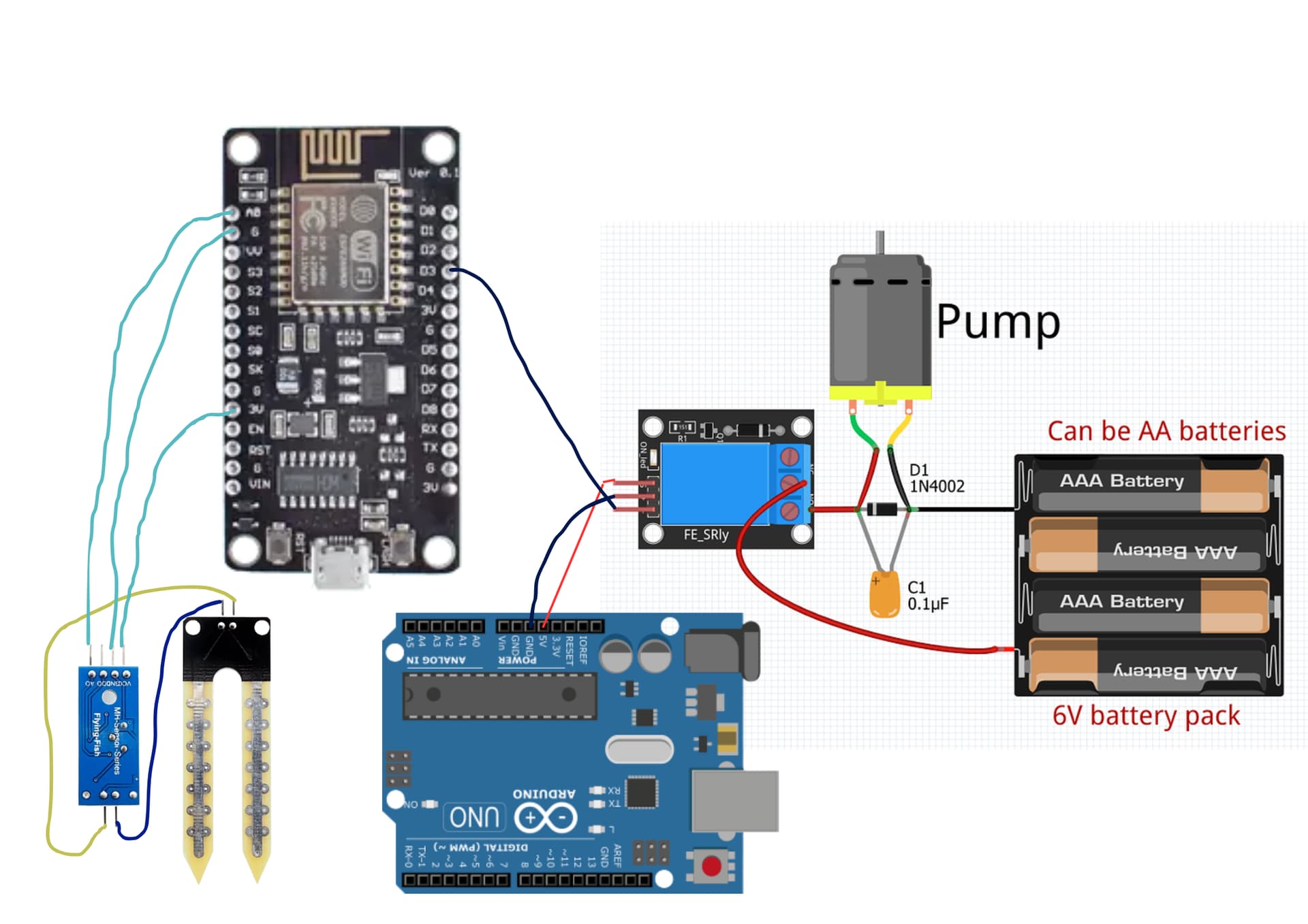

Hi guys, currently i am working on my project which is smart irrigation. Here the wiring detail, all component is working, but the main is the pump doesn't work correctly as the code, like i want the pump off if the soil moisture is above 30%, but when already above 30% the pump still pumping the water, and i see the relay led is turn on the red and the green one, please help me what's wrong?

What part does the Uno play in your project ?
It is not designed to be used as a power supply if that is what you are using it for

#define PUMP_PIN 14  // GPIO14 = D5
but in your picture there is no connection to pin D5
In any case, why not use the 'D' pin number in the code ?
Oh i am so sorry, there's a typo, i'm using D5 esp8266 for the input of relay and The uno i use for the source to relay and lcd i2c which is these two need a 5v input

That is a very bad hardware set-up.
You should not use an Uno as a power source.
Your relay may not work with the 3,3V signal from the 8266
Connecting a 5V relay to the 8266 may damage the 8266.
What relay module do you have?

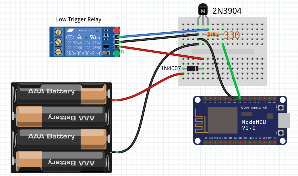

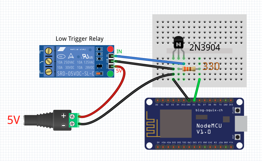

First you have to make the hardware correct, then you can fix the softwate.
You need to connect the relay like this:

okay, thanks for the reference, but is there any other solution besides me having to find a 5v source, I don't know what to replace the 5v, is there any ways like replace a suitable type of relay or something?

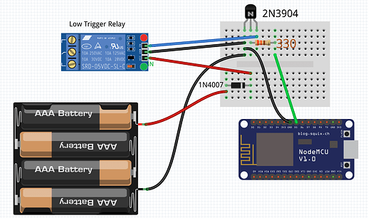

You can use the same battery pack that powers the pump to also power the relay.
Note the diode in the positive lead to the relay
