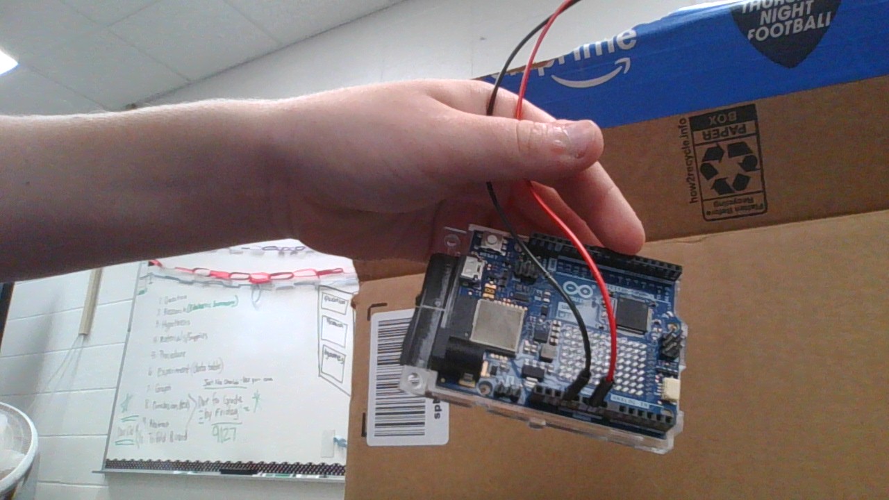

I have the pump in the gnd and 3.3v, the code says to plug it into gnd and 7 but then no power is given to the pump
Can you post some images of your project?
So we can see your component layout.
Your picture shows you with two wires in the Uno R4 wifi. Looks to me like the 3.3V and Gnd.
