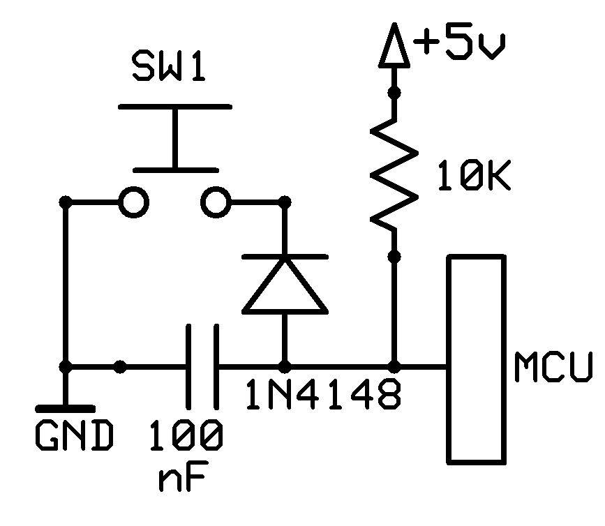

Thank you so much for posting this.
You kind of anticipated my reaction to your first post.
I went through the program.
I don't see which PIN would be assign to the push button to set its pinMode to INPUT.
Do you have the schematic that comes with this program?
UKHeliBob:
It is OK until you want to do something else in loop(), at which point you will find that the code is blocked whilst the input is LOW
Thank you very much UKHeliBob
I wish I had as much knowledge as you do.
What is your secret ?
CanadaForces:
The pin assignment is about 96 lines in... Just above setup(). Yes, the class coding may seem daunting and needlessly complicated for a novice programmer, so it was a bit tongue and cheek, but honestly, it gives a lot more guidance to where you want your programs to grow.
pinMode for the button is set for you with the line Button.inputPullup().
Schematic is pretty standard, see below. The pull-up resistor works like INPUT_PULLUP, only more reliable. The cap squares off the waveform, so high to low and low to high is more up and down and less sawtooth. The diode forces the switch to act only in pull-down fashion, in case of transients or static electricity etc.
