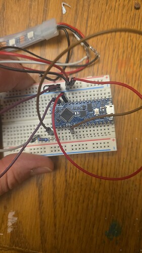

Hi everyone, im actually getting my first project to work and it's time to start on the next phase
So the image is what I have right now, it's a simple setup, a light strip and an arduino nano every that I just load on a program that animates some lights when plugged in
The next step I'd like to take is to set it up so that when a button is pressed the lights animate for a 10-20 seconds. I know it seems a little silly, but it being a button is important
Most of the tutorials I've seen so far have it so that the button completes the circuit so the code only runs when the button is compressed, is there a way that I can press it once and have it play for a bit? Im really new to the hardware side of things so im not totally sure what even to Google, so any tutorials would be a massive help!

I hope your strip is no longer than about 10 LEDs, otherwise you could easily fry your Nano or damage the USB port of your PC/laptop.
I also hope that those wires do not short out. Apply some insulating tape to prevent this.
In that photograph there are some broken wires that look like they need fixing.
You might want to read / reread this How to get the best out of this forum before you proceed any further.
If you must have uninsulated wire splices in close priximity, stagger the lengths so bare wire touches insulation, avoiding shorts.
Very much a newbie, so im gonna ask a newbie question. Is it because of the length of the light strip or is it because of the uninsulated wires? The video I was watching had a similar length of light strip so I didn't think it was an issue, and the raw wires were because I got ahead of myself and forgot to do the last step :sweat_smile:
Fully intend to, just got ahead of myself because I didn't think i was going to get it to work, thanks for the advice. I have shrink tubing, but the wires that I have are getting removed for a different type of input once I'm done prototyping, but by the reactions to this I'm assuming what I did was a big no-no
Definitely gonna insulate them! I'll actually be changing them out for different wires which is why my overly hasty self never put the shrink tubing on it

It's the number of LEDs on the strip.
Each led can consume up to 50~60mA.
USB power from PC/laptop can provide up to 500mA, otherwise the PC/laptop's USB port could be damaged or worse.
Hence max 10 LEDs on the strip.
Got it, thank you! The dude on the tutorial definitely had some kind of different setup than I did, so I'm guessing he had something that would actually make it work. I'll keep it to 10 LEDs for testing. Thankfully the code I have set up randomly sets off roughly a third of of the LEDs for a second so there was never all the LEDs running at once, so hopefully no harm done, thanks for saving a USB port haha
