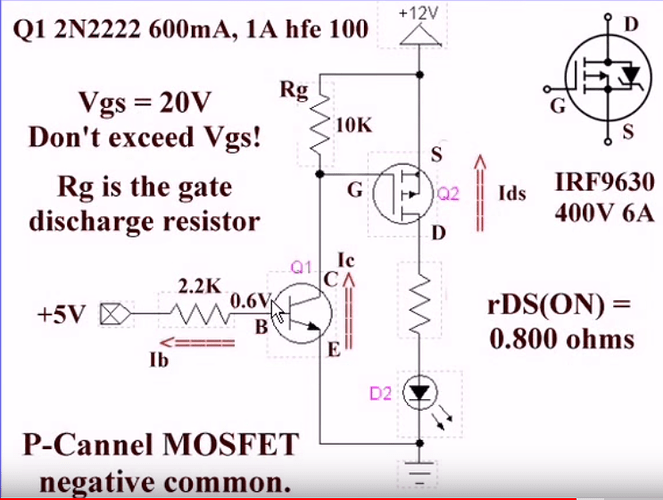

Thank you for your reply. I tried to sketch a diagram using N channel Circuit the way i have things in my head.
Also i found a diagram for a P channel circuit controlled by arduino (with protection to not fry the arduino with 12v line, i think it's what you suggested above).
I would like to use the N channel variant (if correct) because i've been told that on cars it's more risky to work on + line instead of GND but somebody with experience hopefully would lead me to the best choice.
That looks ok. Is the arduino ground connected to the vehicle ground (ie. 0V/chassis)?
Yes, that's what I meant. You would generally use an n-channel MOSFET on the ground side in preference to a p-channel on the 12V side, because the circuit is simpler and the n-channel MOSFETs are cheaper and more robust. But in some situations you have no choice, for example when the negative side of some component is connected directly to ground or a chassis and you have to switch the 12V side.
I have tried the first N-Channel Mosfet diagram and ... it's not working. The arduino it's powered through cigar adaptor using a usb cable so I think the GND from arduino it's connected to GND from the car.
I've updated the diagram I'll try to test tomorrow. Please let me know if I have any errors in it. After PaulRB asked me about the common GND I'm a bit skeptical now if my diagram it's safe or it will fry my arduino.
LE: I've tested it it's working awesome. Thank you PaulRB for your suggestions. As a mention, I separated the ground circuits to not connect together and 12v to go to arduino.
Glad you got it working. I was not suggesting you separate the grounds.
