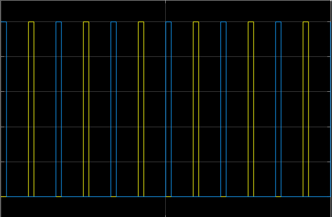

i have a graduation Project to make 2 parallel buck choppers and control the mosfets by arduino, i should send 2 PWM signals to mosfet gates with 30KHz and variable duty cycle between 10 to 90 % and with 180 phase shift between them or 16.67 microseconds, i tried some codes with gives me output signal with frequency 34KHZ but the duty cycle of the 2 signals is not right and i dont know where is the problem so can you help me ?

Actual output
Desired output
Remove the ISR and use the fine hardware features like inverted output signal...
The code in the ISR makes one pin high and the other low, or the other way around. It is never going to give you the desired output. That they don't switch at the same time is because you use two slow digitalWrite() statements, rather than a single fast PORT call which can set two pins at the same time (as long as they're in the same PORT).
The "desired output" graph shows two independent signals: both pins can be low (or, presumably, high) at the same time.

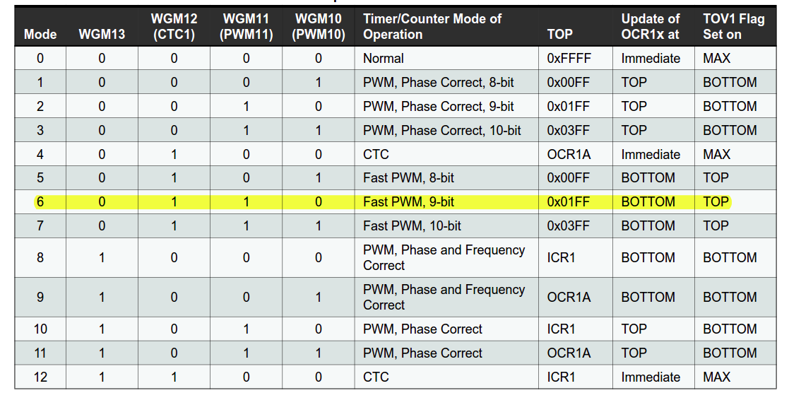

It’s an 8 bit timer, so it counts from 0 to 255.
You have no prescaler so 16Mhz/256 = 62.5kHz
The next lowest frequency you can get with timer 0 is 7.812.5 Hz
so i should use timer 1 as it is 16 bit ? or i didnt get you well ?
also should i use prescaler to get the determined freq?
Yes
Timer1 with no prescale and TOP set to 511 will give you 32.25kHz

#define duty_cycle 25
  // Set pins 5 and 6 as output
  pinMode(9, OUTPUT);
  pinMode(10, OUTPUT);
  // Configure Timer0 for Fast PWM mode
  TCCR1A = (1 << COM1A1) | (1 << COM1B1) | (1 << WGM11) | (1 << WGM10);
  TCCR1B = (1 << CS11);  // No prescaler
  // Set TOP value for desired frequency (30 kHz)
  // Formula: TOP = (F_CPU / (N * desired frequency)) - 1
  // For Arduino Nano (16 MHz), N = 1
  OCR1A = 511;  // TOP value for pin 5 (16 MHz / (8 * 30 kHz) - 1)
  OCR1B = 511;  // TOP value for pin 6 (16 MHz / (8 * 30 kHz) - 1)
  // Adjust duty cycle if needed
  // Example: 50% duty cycle for both pins
  analogWrite(9, (duty_cycle * 128) / 100);
  analogWrite(10, (duty_cycle * 128) / 100);
