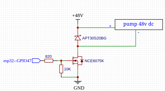

Hello, I'm trying to control 48v dc pump with pwm with esp32s3. regardless of pwm signal pump works on and off...
analogWrite(pump, 819) (eg 20% of 4095) pump is on at 100% same at any duty cycle, analogWrite(pump, 0) pump goes off. Any help will be much appreciated!
that it the pump
schematic uploaded
Bad choice for the MOSFET.
You need one that will fully turn on with a 3.3V gate drive.
One that has a maximum Rds(on) of less than 10mΩ @ a Vgs of 3.3V or less with a Vds of 60V or more.

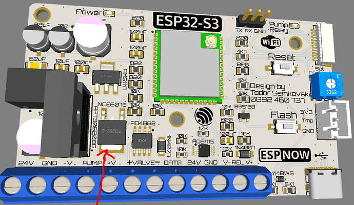

Yes, I can buy from Digi-Key or combine my order with a friend from mouser... I prefer smd part. This is the pcb and current mosfet

You will need to use a standard or 5V logic level MOSFET with a gate driver.

Looks like it was designed for a 24V low current pump but your pump is 48V
Did you design that board?
There may be other issues other than the wrong MOSFET

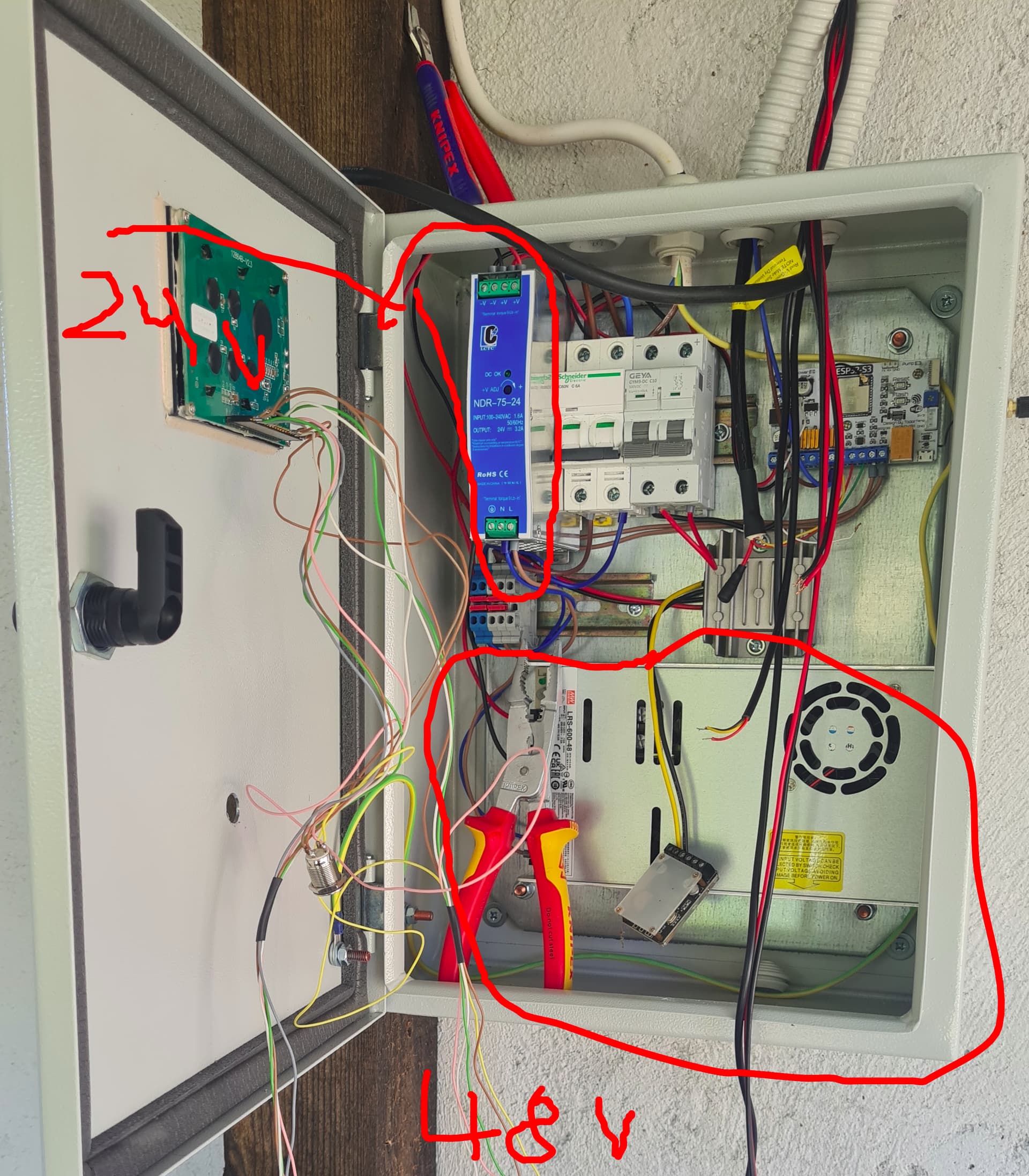

24v is supplied to pcb because valve operate at 24v and i'm switching the pump power supply (second) 2 sec before starting the pump, 48v is present to the board just for the big shotki
can provide the the full schematic if nesesery

No, mosfet currently does the same thing ON-OFF, I need pwm.
I need pwm.
See post #7
Do you understand?

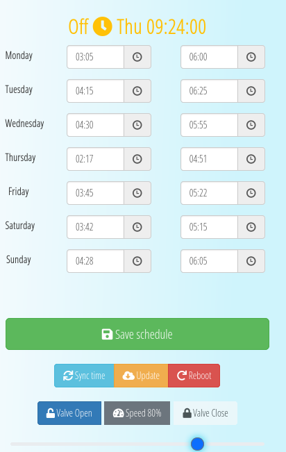

Why do you need to control the pump speed? to reduce water flow remotely, pump used for irrigation plants by schedule
