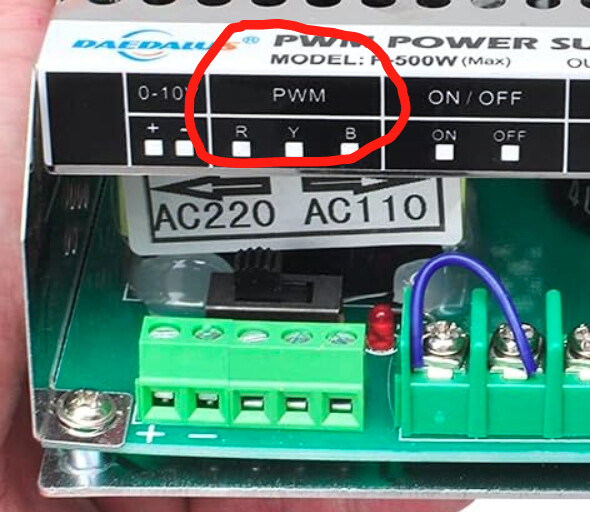

I am trying to implement a control system for a massage chair. This equipment has two DC Motors, but they work with 110VDC, so I’ve been thinking to use a ESP32 with a PWM output to control the power of a Motor Driver, but I would like to know which Motor Driver is recommended to use with this board or is anyone had been in this situation?
I found this:
But don’t know if this one works with an ESP32
So any comment would help
Thanks

You would need additional hardware, such as a DAC.
You could use pwm to 0-10V converter like this to control that Daedalus:
https://aliexpress.com/item/1005006582755517.html
But you need also min 12V power supply.

Got it! That is a good detail, because the ESP32 gives me just 3.3V right??
Not likely because of the information You give.
That device need a min of 4.5V so you will need a level translator to use it with a 3.3V ESP or use a 3.3V DAC
Right.
I have used that module with Esp32 without problems, but like jim-p commented above, description of that module doesn't confirm compatibility with 3.3V PWM signal.
To be sure, better to pick converter that clearly confirms that.
https://www.aliexpress.com/item/1005006246726187.html
I don't know how you want to control your setup, but if it fits your use case, I can recommend Shelly dimmer 0-10V Gen3. More expensive solution, but certified European product with lot of features. Esp32 on-board.
Well this is confusing:
Maybe it can use PWM
