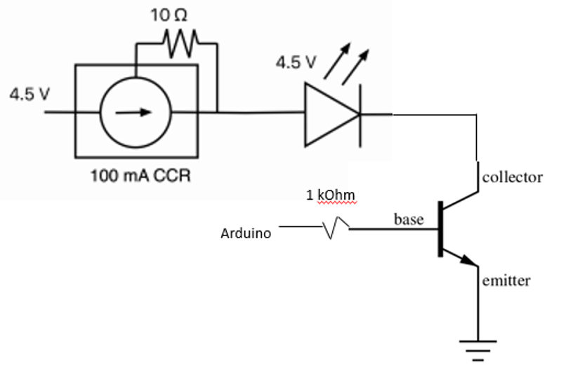

I'm trying to do PWM on a series of high power UV-LEDs, regulating the current using a constant current source, and doing PWM using a NPN transistor. The issue I'm running into is since I added a transistor to the circuit that I turn on and off using an arduino, it turn's on and off like normal up until 9.4 volts, but to get to the full current at 10 volts, the transistor no longer fully shuts off.
Without the transistor, the supply voltage is 4.5 volts with a 3V drop across an LED. The current is 60 mA (although LEDs are spec'd at 700 mA for full power).
After trying to incorporate the transistor (PN2222A) for PWM, the voltage required increases significantly to approximately 10V. Up until 9.4 volts, the code works perfectly to do PWM on the circuit, but it only has a current of 30 to 40 mA rather than the full 60 mA. After increasing the voltage to 9.5 volts suddenly makes it so that the circuit no longer turns off from a simple blinking program. The current decreases though from 60 mA to 40 mA (rather than going to zero).

The CCR that I'm using is NSI45060JDT4G (NSI45060JDT4G onsemi | Integrated Circuits (ICs) | DigiKey).
The thing is though, even when I tried to set up a 1 second ON/OFF blinking circuit instead of PWM, the light stayed on (even though the current did decrease). -
Also, I've attached a circuit, sorry it looks like it was drawn by a 2 year old in paint, I don't have a camera for a hand drawn circuit.

You have got the gnd of the power supply for the LEDs, connected to the gnd of the Arduino?

Try adding R2, I doubt that it will make any difference,but keep the 1K, you need to saturate the transistor to get full current to flow through it.
If you take the the base resistor connection off the Arduino and connect it to 5V instead of the PWM , do you get the same brightness as PWM at 255?
Then connect the same resistor to gnd to see if the transistor switches OFF.
What voltage do you get at the collector of the transistor in either condition.
Also double check the transistor connections, there are 2N2222 and 2N2222A, they have different pinouts.

I can't think of any reason it won't turn off unless the transistor is bad/blown or unless it's wired wrong.
It should work without R2. You might try a lower value for R1 (maybe 1K) to turn the transistor on "harder" for more current when it's on. (Changing R1 won't help with the turn-off problem.)
I have the ground of my arduino connected to the ground of my power supply,
And the transistor emitter is also connected Arduino ground?
R1 should be 150 or 220 ohms not an astronomical 4.7k, R2 then does nothing, lose it.

Well, this was my problem it seems... Very noobish mistake, kind of embarrassing, had the transmitter and the collector mixed up in my actual circuit. I guess I figured I had it write because it worked initially for the lower voltages. Thank you all so much for the help in solving this problem, you all are great!
