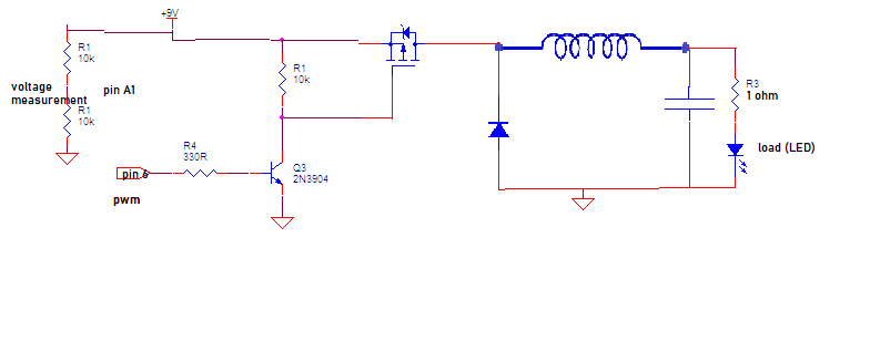

I made a buck converter with an Arduino that tries to keep the INPUT voltage constant. The input is a solar panel.
Every 5 minutes, the programme stops and checks the open circuit voltage to adjust accordingly.
After approximately 8 minutes, digital pin 6 (connected to the mosfet) stops working. It outputs 40 mV (practically 0) independent on the stated duty-cycle (even if it sais that it is giving it 200 out of 255, it still outputs a very small voltage).

Your schematic shows only a small portion of your circuit. Please post schematics for the entire system, so that we can gain a full understanding of the operation of your mostly undocumented code.
Assuming "+9" in your schematic is the buck converter output, the remainder of the circuit appears to just turn an LED on and off. I happen to know that it's probably an optocoupler, but most people wouldn't get that right away.
I have put the schematic.
The arduino IS the buck converter.
The pwm pin stops working after some time
Ok, thanks for that updated diagram and code, it's very helpful. In future, though, please don't edit previous posts, as it makes the replies seem like nonsense.
May I ask, how are you measuring the PWM voltage? A DMM can't read such signals accurately.
Your schematic/wiring diagram is still incomplete, the code references A5 and you have shown no connection to it.

  1. Yes, using multimeter to measure pwm voltage. From my testing, it shows accurate readings on pwm (it also sais that is measures "true rms").
    Multimeter shows almost 0V on pin 6 and mosfet is OFF, thus the voltage actually is 0V.
  2. A5 is connected to ground, ignore it.

I looked at my original circuit design and saw that I had connected the diode wrong. The inductor could not "discharge" during the OFF period, thus creating negative voltage spikes. I guess the arduino didn't like the surges in potential, and would stop working after a couple of minutes.
After fixing the circuit, it works well.
