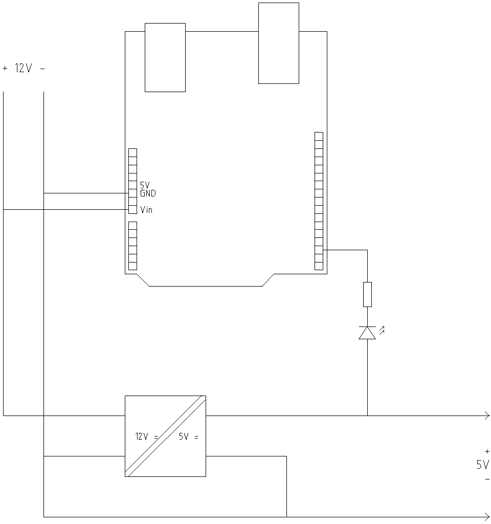

A Calculation:
The Mega board is equipped with a 1117 regulator for 5V. It sits on a copper lane of - roughly estimated - 10x15mm. The datasheet gives a max. dissipation of 1W or slightly above. At 12V input that means max 150mA. The CPU of the 2560 takes 20mA, the 16U2 USB interface 15mA, adding some small stuff on the board and about 50mA is needed even doing nothing. If the LEDs take 100mA, the 1117 is on the brink of thermal shutdown.
Two possible solutions:
1: Switch the LEDs negative, between external 5 V and the outputs, keeping the board supplied with 12V at the Vin pin.
2: Supply the external 5V into the 5V pin, but mind decoupling.

Are you saying I connect the long side (electricity in) of the LED to my power supply, and the short ground side to the Mega pins... and then use digitalWrite(pin, HIGH) to essentially block electricity flow, and digitalWrite(pin, LOW) to allow electricity to flow from the power supply, through the LED, and into the Mega to ground? This makes a lot more sense if it works but figured I would ask if this is what you meant before I tried it.
(Also to your other question, yes I am familiar with millis(), thanks to some helpful folks in my first thread on this forum about 8 months ago).
When I have them set to digitalWrite(pin, HIGH), they are drawing current to be lit up. If I am understanding correctly, you might be getting at what stitech was suggesting with swapping that functionality so the LEDs get current directly from the supply?
I think you're right, good point! Honestly I just assumed 12V would be easier to find because of car batteries and stuff. But since I power some LED stuff directly from the power source, I am guessing I should still find a converter to convert the 6V to 5V (rather than my current 12V to 5V) before stuff gets connected to it?
A picture says more than thousand words:
Indeed, digitalWrite(pin, LOW) turns the LED on.
Mind that the 5V pin is used, not Vin.
If used in a car, why not from the car battery?
Your first picture looks like how I have things set up now. I am a little confused about the second one though. Can you spell out the difference between the Vin and 5V pins? I just don't follow why that matters. And what are the 470u and 1R notations for?
Regarding the car battery, I am also looking into some exterior LEDs, which take up a lot of current I believe. So if I went to a car show or something that lasts a few hours, I could see it draining the battery pretty heavily and risking the headache of needing a jump at the end of the event. I just figured a separate battery would help ensure I didn't add additional problems to the car itself. I am still quite new to this so having as many systems isolated as I can, should help narrow down the list of potential causes when something goes wrong (with the car, or the lights/Mega/etc.)
The Vin pin leads to the regulator. Possible spikes and noise will be regulated away. But: the input of the regulator needs to be sufficiently higher than the desired voltage, or the regulator can't regulate. In that case the input voltage will be passed through, losing more than 1V, while all the noise also passes through.
The output of the regulator is connected to the 5V pin and the supply pins of the chips. The board contains some decoupling to suppress spikes and noise, and it's possible that that allows the system to operate just fine. I added an extra filter, better safe than sorry. The 1 Ohm resistor is a wild guess, the filtering will be better with a bigger resistor, but there will be more voltage drop (a few tenths of a Volt is no problem, you'll lose that anyway when supplied from USB).

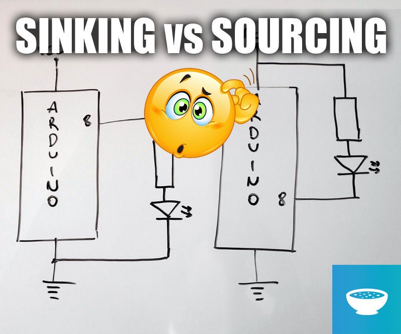

Driving LEDs
but that is just for indicator LEDs.
Yes so they will need to be controlled seperately.
Great site! It covers a lot of things I have been learning about with my projects. One thing I will mention though - you say:
... but as far as I can tell, you don't say what those are :slight_smile: I am guessing an advantage to the second one is less current being sent out of the Arduino, which is good because it does have an upper limit to that. And maybe an advantage to the first one is that the ground line stays free of current and there is less risk of an accidental short causing the LED to burn out? I am sure there is more I am not thinking of.
no. whichever you use the current always flows in the ground. Current always flows in a loop from the supply and back to it.
However with LED & R to + the current flows back through the arduino ground pin.
In 1 the LED is ON when the output is HIGH.
More here
Ohh OK, nevermind then :slight_smile: Thanks for that additional video explanation!
