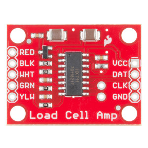

Hi Ron,
thanks again for the reply. I have now ordered some of those high precision sensors and I understand that they are necessary.
Yes, it is as you described, I am using the red HX711 chip as can be seen below:
I have wired it to the 5V of the arduino. The only thing I find weird is that there is a 3.7 V excitation voltage across the black and red but still absolutely nothing happens to the raw readings, and they remain completely constant. Shouldn't they be at least somehow changing, even if the bridge is not completely balanced (as it is not now due to me only using regular resistors), since I am actually measuring an output voltage of a few 10s of millivolts now across the bridge?
Yes, if you apply excitation and flex the strain gauge you should see a small change in the output. A very small change but noticiable on a good DMM or bench meter.
The module gives a data out but you should see an analog voltage change at your bridge out.
