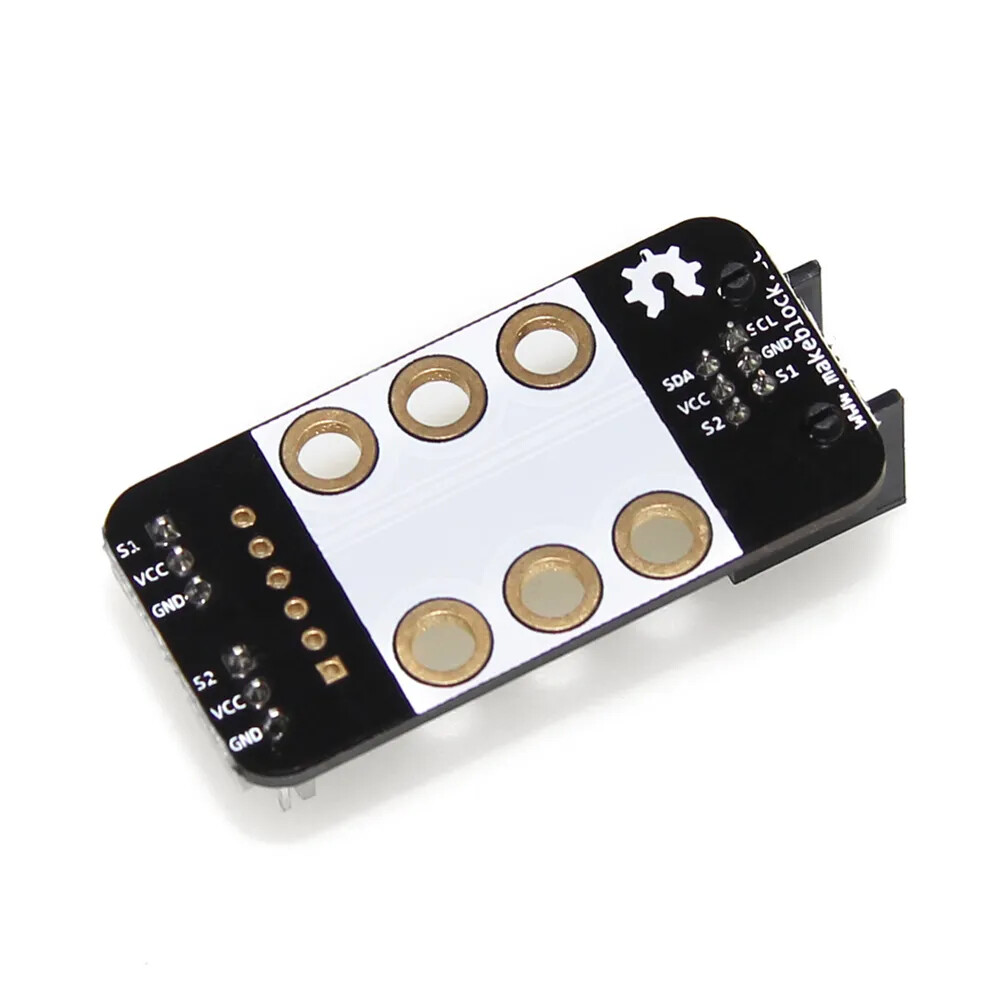

So if I'm right, I can connect both without issue? (I already have an adaptator from RJ25 to classic wires.
If you want to see here is my card and the sensor :
I will try next week and I will keep you udpated :slight_smile:
As I already said, you can connect the mma8452q to an Uno but I know nothing about that other boardthat you show. What is it? Do you have a datasheet and schematic?
What are these for?
I have the card I show you in the previous text, it can be programmed like an Uno and I have an adaptator to use the card as an Uno.
On the card these are the output :SCL SDA GND 5V S1 S2.
And on the sensor : VCC 3.3V GND SCL SDA SA01 INT1 INT2.
Then connect VCC to 5V, SCL to SCL, SDA to SDA, and GND to GND.
The Uno does not have S1 or S2 so I don't know what they are.
Do you have a schematic for that card?
Here is the schematic:
I would use RJ25 Port 2.
S1 is Uno D9 and S2 is Uno D10. If needed, you can connect INT1 and INT2 to those pins.

I uploaded and ran the i2c_scanner.ino, unfortunetly I get an 'No I2C devices found' message. It really looks like the material can't be detected, however I doubled checked the wiring and found no mistake, I think I will need a multimeter to check tensions if the sensor.
Yes most likely a connection problem. I see that the adaptor board was not designed for the jumper wires, are you sure that ar making a good connection?
Disconnect everything!
Those white connectors do not have SCL and SDA on them.
See images below.
You are right, the white part isn't useful here, and by connecting to the correct output ... IT WORKS !
