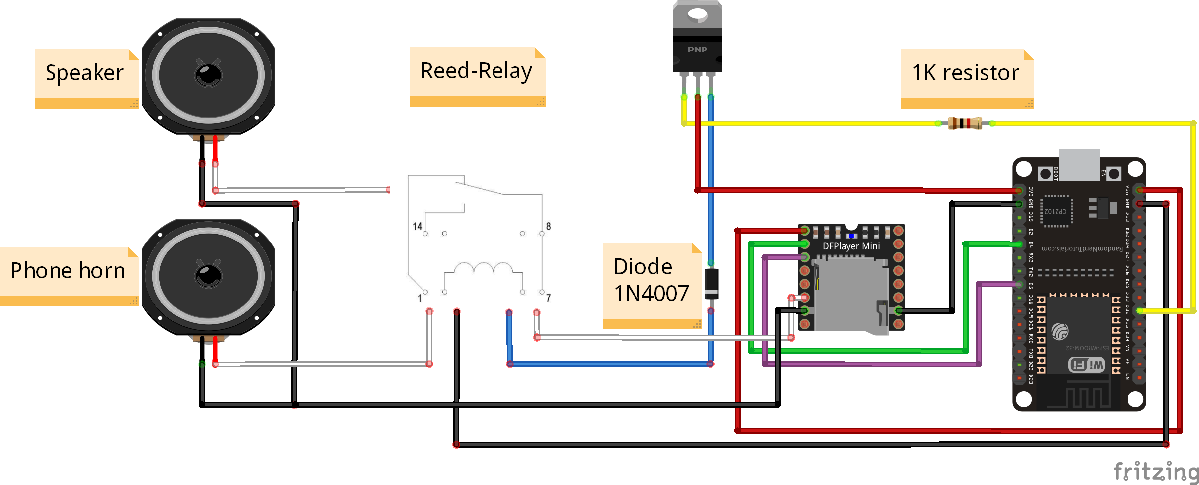

If I look at the schematics given by the example I think I can create something with this:
relay_schematic
I need to order some transistors and that diode that is mentioned. But first I think I'll redraw a new solution in Fritzing. Once I done that, would you be so kind to review it and see if I forgot something or did something wrong?
The link is broken!
For the transistor, an ordinary BJT like BC337 or MOSFET like 2N7000 should be fine. For the diode, 1N4001 or similar.

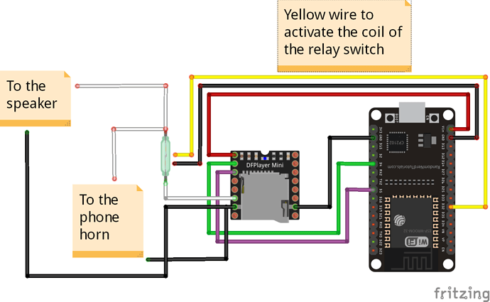

Ouch. Thanks for that comment. No the speaker line and horn line are connected to two different "exits" of the reed-relay. They are not connected. If the power to the reed-relay is off, the audio is sent to the horn. If the power is high, the sound will be relayed to the speaker. Schematic:
reed-relay-layout
I'll adjust that image for clarity. My apologies for the confusion.
So your reed relay is SPDT? Are you certain?

OK. First of all thank to you all for thinking along. I took all your input and put it in a Fritzing image to check with you all to see if this might be a solution. This is as far as I came so far, waiting for further feedback to perfect it.
Since the Reed-Switch was not available in Fritzing I pasted it afterwards. For the MOSFET or Transistor Collector I made use of the 3v3 pin of the ESP32. Is that handy or should I make use of a separate power source? The 3v3 seemed to work in earlier settings.
I also incorporated the 1N4007 diode as a safety measure against the high voltage.
If you good people see anything that's questionable please comment. Since this is kind of new to me please don't be harsh but definitely critical.
My thanks again for all your input.
A hand drawn schematic is much better than any Fritzing. As you're finding out now there are quite some limitations to Fritzing and the worst of all is that despite its fancy icons and pretty colors it tends to yield a kind of digital spaghetti that's just confusing to read.
Aside from that, looks like you've got that transistor and diode wired up wrong. Compare it to the schematic earlier int he thread.

That diode won't see any more than the supply voltage so the 1N4001 to 1N4004 range is better suited for the job than an 1N4007.
Leo..

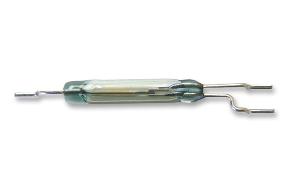

Can you also post link to specs/data of your relay please?
The NC contact is simply non-magnetic.
https://uk.farnell.com/productimages/large/en_GB/2453626-40.jpg
