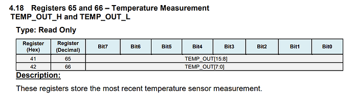

i've been following some tutorials of how the I2C bus works and have a small question of understanding.
So in this tutorial he is reading out the temperature of the sensor. The manual shows that it seems to be stored in 2 different adresses TEMP_OUT_H and TEMP_OUT_L (0x41 & 0x42):
In the tutorial he only adresses the "0x41" register at the beginning, but for some reason is able to read out 2 temperature bytes. How is this possible, if he never adressed "0x42"?
Also, what is the purpose of shifting the bits afterwards?
 int16_t raw_temp = temp_h << 8 | temp_l;

On the I2C bus, every I2C device has a "I2C address".
A sensor has often registers, the register is selected by the "register address" or "register pointer", or "register index".
Most I2C devices allows that multiple bytes are read. The I2C device increments the "register address" after every read byte. Sometimes only 2 or 4 bytes can be read sequentially, but often there is no limit, you can just go on reading bytes in the same I2C session.
The sensor has data for TEMP_OUT, a 16 bit value. That has to be re-constructed in the Arduino to get that same 16 bit value.
The sensor chip automatically increases the internal register address to 0x42 for the second byte. If 3 bytes were to be requested, it would increase to 0x43 for the third byte and so on.
Most register-based I2C chips do an auto-increment of the register number thus allowing to read any number of registers in one transmission. See the data sheet of your chip.
This way two bytes are combined into one (16 bit) int.

The temperature sensor produces 16-bit data which are stored into two 8-bit registers and their names are: TEMP_OUT[15:8] and TEMP_OUT[7:0].
To get single piece of 16-bit temperature data, the 8-bit content of TEMP_OUT[15:8] is to be aligned with the 8-bit content of TEMP_OUT[7:0] as per Fig-1.
tempAlign

The comment is not clear. It should be: //Pointing to TEMP_OUT[7:0] register
After reading the TEMP-OUT[7:0] register, the pointer will be automatically incremented to point/address the next TEMP_OUT[15:8] register.
