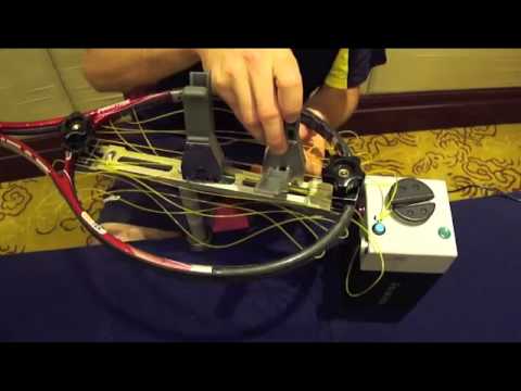

Are you trying to build one of these?
I have decided to use wiper motor since it has a lot of torque. Instead of load cell i decided to controll torque using ACS712 5A hall sensor. Basically when motor exceeds certain value of amps arduino will tell motor to stop. Here is the code I wrote but didnt get chance to test it. can you please tell me if there is better way to work more accurate or better code than this. I am just a beginer with arduino and every help would be appreciated. thanks in advance. Here is the code:

Using motor current to estimate torque is not a good idea, as gearbox and bearing friction will not necessarily be constant.
The youtube presentation by the looks of it, has the motor base hinged and spring mounted, the spring contracts as the tension increase and there would be a microswitch placed to trip the motor stop.
The side adjustment moves the switch for different travel/force of the motor base, hence string tension.
So it has no electronics as such.
A wiper motor would be a good idea, because of the torque and most are worm drive so will not run backwards under tension when power is removed.
Tom.... :slight_smile:
