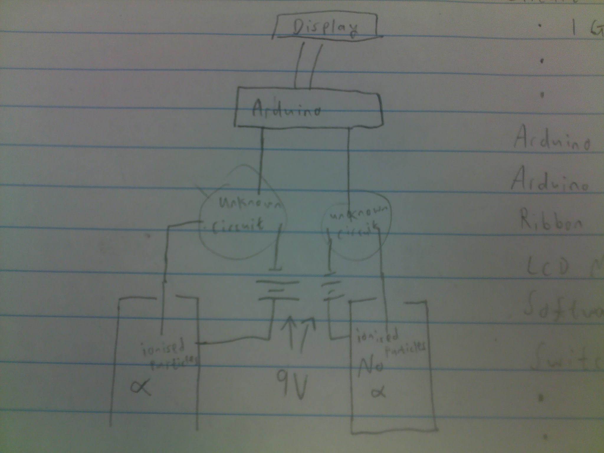

Are those two circled capacitor like things supposed to be the ionisation chamber?
The setup we had in mind is as attached. We need two separate 9V batteries, one for each chamber. The unknown circuit is circled.
Really was hoping to keep this as simple as possible, but it's turning out a bit complex. Don't want to use an additional PCB or breadboard, because the electronics setup is already a bit clunky, won't give us much freedom in designing the actual chamber. Initially thought it was going to simply be an additional component added into that 'unknown circuit' bit. :confused: Is there really no other way to do this?

The "unknown circuit" could comprise a suitable op amp with low input bias current, configured as a non-inverting amplifier. See attached schematic. If you want to run the op amp from the 9V battery, then you should use an op amp with very low current consumption, in order to get good battery life. The MCP603 has a supply voltage limit of 6V, so you can't use that unless you feed it from a micropower voltage regulator (e.g. MCP1702). The TS271 would be a good choice, although it needs an additional resistor connected between the Rset pin and ground. LMC662 is less suitable as it draws a couple of mA.
The 10K resistor in series with the output is there to protect the Arduino input if the output voltage goes above 5V.
