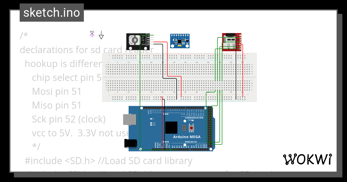

I've started a sketch using the simulator. I'm trying to read out to the SD card. The simulator shows SD files, but there are none listed. It seems to be just ignoring the "read" command. Is this an artifact of the simulator, or am I expecting to see an actual file output?
Code is attached below. The serial monitor does give the two "check" outputs, so it looks like the SD read functions are working. I just don't see anywhere there's an output.
Serial monitor output:
check1check2The distance is: 1.00 pulses
declarations for sd card reader
  hookup is different for mega from uno in examples
     Miso pin 50  (output)
     Mosi pin 51  (input)
     Sck pin 52 (clock)
     chip select pin 53, not 4 as in uno
     vcc to 5V.  3.3V not used

Please say you found the documentation for the wokwi SD card reader, tried the examples then slavishly followed every step it takes it your own code.
If you select a wokwi part, the question mark symbol links to the document for it.
When you make a wokwi project and come here for help, post a link to it so we can play with exact the same thing alla way over here where we are!
Yours will remain unmodified, we work with copies.
a7
Documentation can be found here: wokwi-microsd-card Reference | Wokwi Docs
I don't see any mention of where the output goes or how to tell if it's successfully writing.
The example listed there is quite different from what I'm trying to do, so I based my code mostly on:
https://toptechboy.com/arduino-lesson-21-log-sensor-data-to-an-sd-card/
and https://www.youtube.com/watch?v=-nXSUXJz4QQ
I note in running the example that it only writes to the serial monitor, not the SD card, so that's not helpful to me. I was puzzled to see SD listed as a tab with a "no files yet" message, although the output shows multiple files.
The links I posted also had a couple of tips that aren't in the simulator documentation, such as keeping filenames short and blocking pin 10. He didn't explain, and I haven't seen that elsewhere yet.
So I'm still puzzled; my code seems to work since it writes my debugging statements to the serial monitor after the if statement, but I don't see output anywhere. I still have the original question: is this an artifact of the simulator? If not, where did my output go?
You and me both. Sry, usually the wokwi parts and documentation can be met halfway with some common sense and logic.
I have spent some time just now and must stop… trying this and that just won't work in this case; one hopes the entire SD feature of the wokwi is documented somewhere. I made no sense of what was happening with the examples.

@railwayguy to add files to the wokwi SD example you need a "Club" subscription, but you can still test SD operations without actually being able to add the files to the SD tab.
I modified the example at the following link microsd-card-sdfat.ino - Wokwi ESP32, STM32, Arduino Simulator
My modifications are a from the Arduino example and are a little crude but should be fairly easy to figure out and make them work for your own purpose.
First thing is to add a read and write function at the end of the existing code
  void write_file(){
  File myFile = sd.open("test.txt", FILE_WRITE);
  // if the file opened okay, write to it:
  if (myFile) {
    Serial.print("Writing to test.txt...");
    myFile.println("testing 1, 2, 3.");
    // close the file:
  myFile.close();
  Serial.println("done.");
  void read_file(){
  File myFile = sd.open("test.txt");
  if (myFile) {
    Serial.println("test.txt:");
    // read from the file until there's nothing else in it:
    while (myFile.available()) {
      Serial.write(myFile.read());
    // close the file:
    myFile.close();
To make this work we need a small alteration in the setup method, its pretty easy to see where this goes
  write_file();
  Serial.println("Files on card:");
  Serial.println("   Size    Name");
  sd.ls(LS_R | LS_SIZE);
  Serial.println();
  Serial.println("Reading test.txt");
  read_file();
Just try appending or deleting data to get a feel for it
