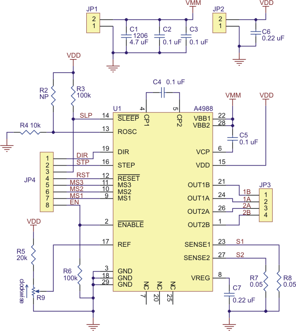

I looked in the datasheet and can't find any way to set the current limit for the board. I 'm not worried about the PS because the current display will show any current (I can see even very small currents when I'm running dc motors with the motor shield) and so far I haven't seen ANY current with this stepper driver. When I ran both steppers using my DK Motor Shield and the Adafruit Motor Library MultiStepper example , the current ranged from 0.2A to 0.6A depending on how high I set the speed parameter.

I have the trim pot (I tried different positions with no effect) but I couldn't find anything about any test point on the pololu site.
Extract from the section on current limiting on this page
Another way to set the current limit is to measure the voltage on the “ref” pin and to calculate the resulting current limit (the current sense resistors are 0.05?). The ref pin voltage is accessible on a via that is circled on the bottom silkscreen of the circuit board. The current limit relates to the reference voltage as follows:
And you can see it in the photo of the board with the coin. The test point is accessible from both sides of the board.

Low Current Microstepping. Intended for applications where the minimum on-time prevents the output current from regulating to the programmed current level at low current steps. To prevent this, the device can be set to operate in Mixed decay mode on both rising and falling portions of the current waveform. This feature is implemented by shorting the ROSC pin to ground. In this state, the off-time is internally set to 30 ?s.
Internal PWM Current Control. Each full-bridge is controlled by a fixed off-time PWM current control circuit that limits the load current to a desired value, ITRIP . Initially, a diagonal pair of source and sink FET outputs are enabled and current flows through the motor winding and the current sense resistor, RSx. When the voltage across RSx equals the DAC output voltage, the current sense comparator resets the PWM latch. The latch then turns off the appropriate source driver and initiates a fixed off time decay mod The maximum value of current limiting is set by the selection of RSx and the voltage at the VREF pin. The transconductance function is approximated by the maximum value of current limiting, ITripMAX (A), which is set by ITripMAX = VREF / ( 8 ? RS) where RS is the resistance of the sense resistor (?) and VREF is the input voltage on the REF pin (V). The DAC output reduces the VREF output to the current sense comparator in precise steps, such that Itrip = (%ITripMAX / 100) × ITripMAX (See table 2 for %ITripMAX at each step.) It is critical that the maximum rating (0.5 V) on the SENSE1 and SENSE2 pins is not exceeded. Fixed Off-Time. The internal PWM current control circuitry uses a one-shot circuit to control the duration of time that the DMOS FETs remain off. The off-time, tOFF, is determined by the ROSC terminal.
The ROSC terminal has three settings: ? ROSC tied to VDD — off-time internally set to 30 ?s, decay mode is automatic Mixed decay except when in full step where decay mode is set to Slow decay ? ROSC tied directly to ground — off time internally set to 30 ?s, current decay is set to Mixed decay for both increasing and decreasing currents, except in full step where decay mode is set to Slow decay. (See Low Current Microstepping section ROSC through a resistor to ground — off-time is determined by the following formula, the decay mode is automatic Mixed decay for all step modes. tOFF ? ROSC ? 825 Where tOFF is in ?s.
The chip is a fine pitch surface mount and there's no way I can measure the voltage on the Vref pin. I should be able to locate the 0.05 ohm sense resistors and measure the voltage on those.
http://forum.olymega.org/viewtopic.php?f=66&t=85&start=20#p424
Current = 2.5xVref
So 400mV gives you 1A
Vref is a lot easier to measure because it is a DC voltage. See that little through-hole between the capacitor and the A4988 chip? Measure it there while adjusting the pot.
I'm changing out a resistor on mine, because most of them come with R5 -way- too small, so most of the adjustment on R9 is compressed at the CCW end.
Details of all of this at the link above.
Oh, yeah. If you use Vref as a measure to set the current, the motors do not have to even be attached, and the board does not have to be enabled.

Well... Vref is the wiper arm of the trimpot, so you should be able to put an alligator clip on a metal screwdriver while adjusting it.
