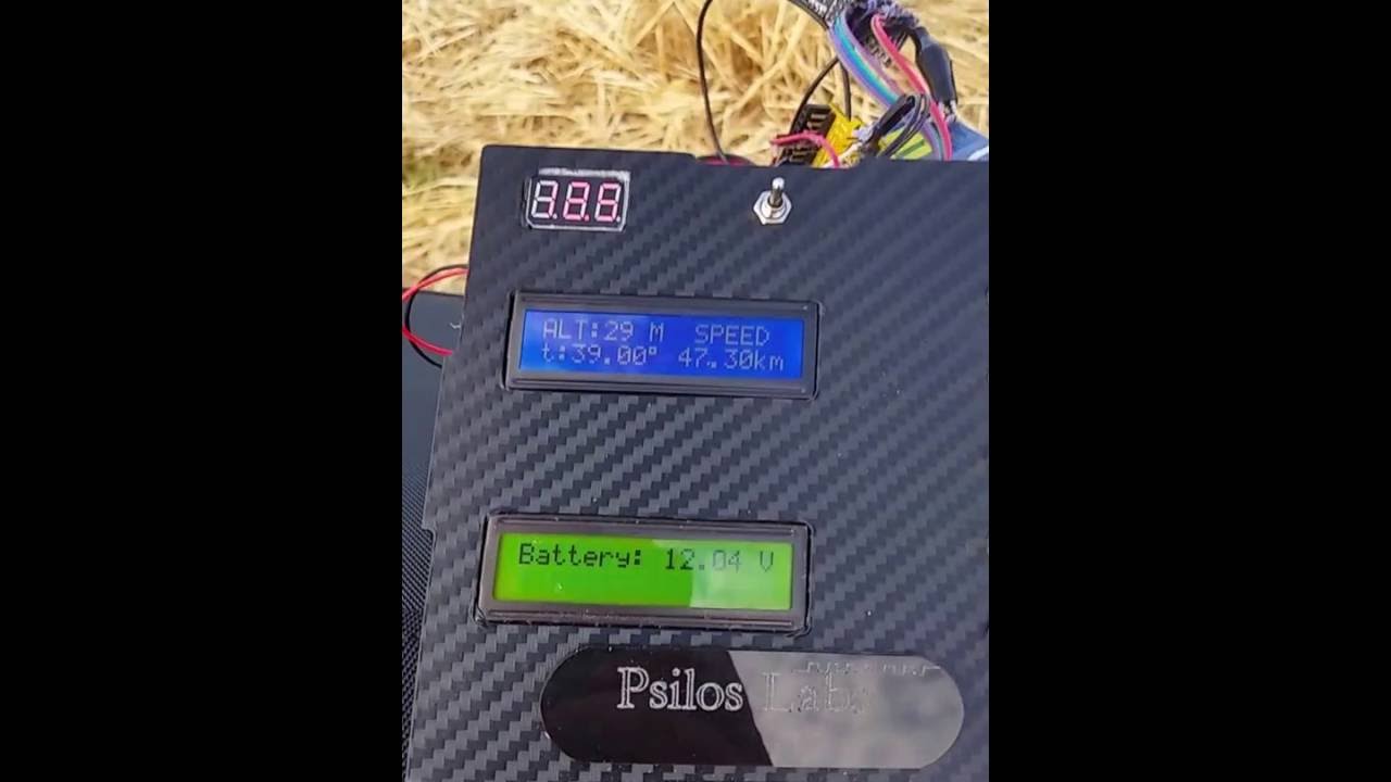

I built a telemetry pair for a friend. An idea I used to have for a really long time, but I had lack of interest to do it only for myself.
All the system is based on arduino pro mini and NRF24L01 Transceiver module. (on the very beggining I had problems with the code on the atmega328 on the TX side and so I was forced to use atmega2560 for TX which was quite heavy for that application. After the code optimized runs fine on the atmega328)
The data that is transmitted at this point :
Speed (km/h)
Altitude(m)
Temperature (internal) (Celsius)
Battery Voltage of the battery of the plane (up to 4s battery) .
Here is on the field test
I am interested in increasing the range of the system , so will need a different TX/RX module instead of NRF24L01.
Can you suggest me a more powerful data link pair ?
If interested in helping or provide any ideas please post here or on my blog.

Hello, the maximum range I have reached using NRF24L01 + PA + LNA is 2kM line of sight with stationary modules , in the wilderness.
In a moving airplane i have reached so far 1kM LOS but did not reach the limit of the range.
The range that I want is 10kM but i do not need high data rate or transceiver modules (just a transmitter and a receiver)
