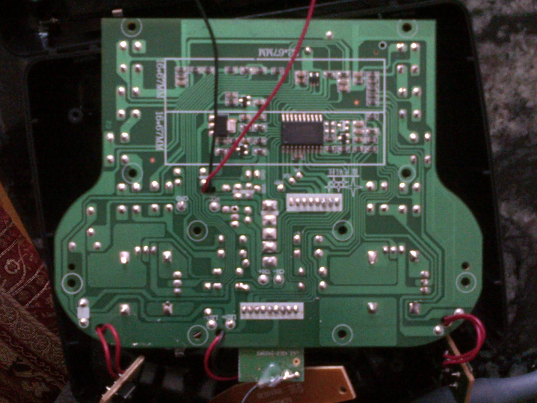

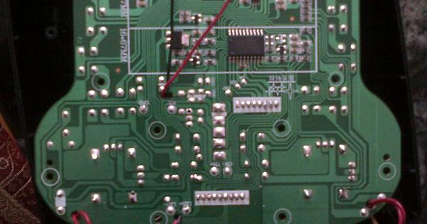

I am trying to control my RC plane with arduino instead of the transmitter. I will need some digital potentiometers to replace the joysticks....I don't know though of what PCB pins of the joysticks I must solder the digital pots too or how joysticks pots work.
I don't know too much about hardware but I opened up my transmitter and took some pics in hopes that someone here can help me out.
I got a digital multi-meter and measured those 3 solder pins on the PCB and got 3.3 V. I don't know what was going on in the PCB but probing the region at the joystick's location gave 3.3V so it must mean the logic level TX operates on is 3.3 V. Each joystick can move up/down/left/right. Do I need 4 digital pots? What valued pots and resistors do I need to simulate the joysticks with arduino?
Very difficult method to accomplish the task. Best method is to utilize R/C radio transmitter that has a 'trainer port' and utilize PPM serial data to send directly out to the R/C receiver, bypassing all the analog voltage conversion hardware and much software.
I need digital pots because I don't want to use the joysticks to control the rc plane..I want to use arduino instead. Arduino can't control the joysticks unless I put some servo to mechanically turn the sticks but isn't it much better if I use digital pots?
Should I just buy some stepper motors and use those instead to mechanically control the transmitter? Normal pots have 3 leads so if you have 2 pots then you should have 6 leads but the joystick pots I see on google have more than 6 leads so I can't tell what is going on... But I can't tell on the PCB where the leads for each pot are and how the joystick pot system works.

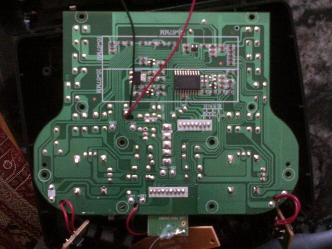

I am trying to control my RC plane with arduino instead of the transmitter. I will need some digital potentiometers to replace the joysticks....I don't know though of what PCB pins of the joysticks I must solder the digital pots to or how joysticks pots work.

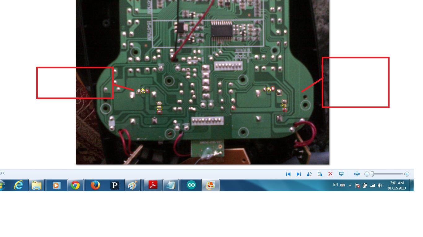

The yellow circles I have circled are the pot's output and brown is GND and RED is 3.3 V . Instead of these pots, I would like to solder onto the input hole where the current pot's output goes to.
The problem with potentiometers in an existing circuit is that you don't know if they are acting as voltage dividers or as variable resistors controlling current or some time constant. So advice is hard to give unless you provide some more info
I believe they are acting as voltage dividers in this circuit because this pot is in a transmitter of a remote control car. This pot is a joystick which control's the rc car's speed and the other pot controls direction.
The pot operates between 0 and 3.3 V so I need to use the arduino to simulate this pot...What can I do to simulate it? Maybe use PWM and a low pass filter? Joystick at middle position gives a 1.67 V after I measured with a DMM and fully pushed gives 3.3V.

It sounds as if you have measured the voltages and confirmed that the pots are being used as voltage dividers, but if you haven't made sure then you need to do that.
It's possible to get digital pots which behave similarly from the point of view of the circuit but can be controlled electronically.
If the end terminals of the pot are at fixed voltages and it's only being used as a variable voltage source then you could use a DAC (or make a DIY version using PWM and an external smoothing circuit) to replace it. Depending what the circuit is doing with your voltage, it may be absolutely essential that it is smoothed perfectly, or smoothing may not be necessary at all.
