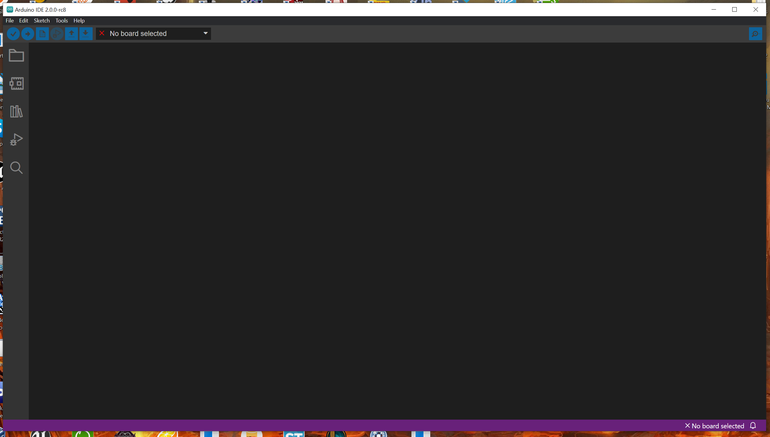

Is it completely empty, like some of the descriptions in arduino/arduino-ide#1044:

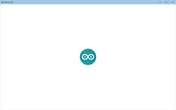

Or does it have the loading animation like what I reported in arduino/arduino-ide#922? At the time of that report, the animation was a spinning circle of dots, but I think since 2.0.0-rc9.2 it will be the pulsing Arduino logo like this:

Yes, might not even have the shortcut bar at the left. Can't remember for sure, should have taken a screenshot :frowning:

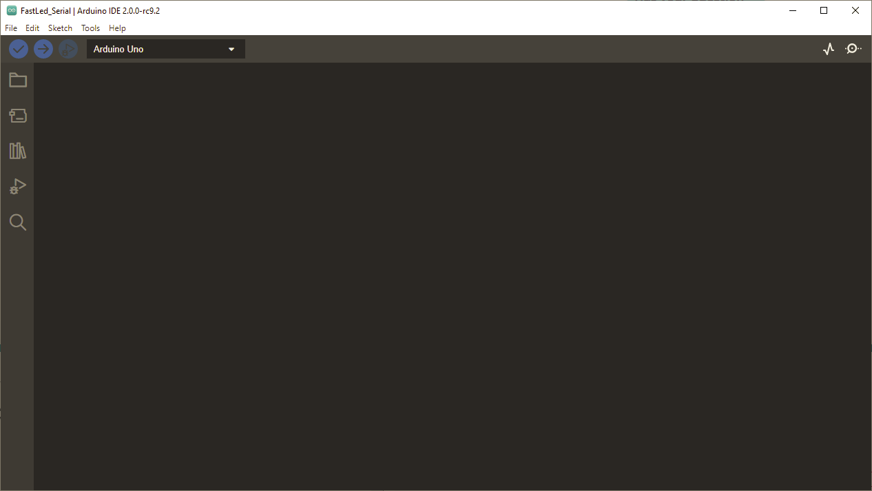

Happened again :wink:
3 IDE windows open; third one showed the behaviour
Relevant (I think) part of the log

I don't think that there is action needed from the Arduino side; this is more to keep track of the number of occurences.
PS:
Other IDE windows could be closed in the usual way.
