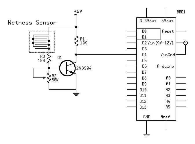

For the sensor, two bare wires placed in different holes in corrugated cardboard.
This makes a good "water on the floor" sensor.

I use a piece of PCB with fingers, like this one: http://www.circuitstew.com/pcbs/water_alarm.html
An Arduino is certainly overkill as you need only about four parts to make a very reliable leak detector. Google "water leak alarm circuit" for thousands of possibilities.
A float switch is more reliable than wires. The DC current through the wires will corrode them relatively quickly. You may need to build a dam around the pump to get a deep enough puddle for the float switch to float.

If it is just for an alarm then you simply replace the cardboard sensor as needed.

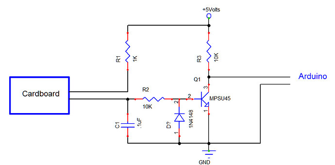

Plausible circuit - almost - but why do people always dash off something straight from "Electronics for beginners" rather than thinking about the design?
Having one sensor terminal connected to 5V is just asking for corrosion to occur, and for the device to fail if either or both sensor wires are more strongly conducting to ground (such as perhaps - a floor?) than to each other. At least the 1k resistor prevents such a short to ground from affecting the power supply itself.
The more appropriate circuit would have the sensor between the input terminal (of the Arduino directly would be OK if isolated by a 47k resistor) and ground with a "shunt" resistor to 5V of 47k or so. In fact, that "5V" could be provided by another Arduino pin which was only pulsed HIGH occasionally when necessary to make a reading, and the sensor connected only via a capacitor (maybe 1µF, ceramic or plastic) to remove any DC current which could cause electrolysis.

I have used this cct. for years.
I have experienced zero corrosion as this is a dry sensor (until there is an alarm, then you exchange the cardboard). There is no electrolysis.
The cct. power supply is from a wallwart isolated from earth.
The cct. is designed like this to support long cable lengths (some of mine are 30+ feet).
I have used multiple sensors attached in parallel to the same input point.

There are varying expectations of engineering - "just enough" to get the job done, or robust.
I am sure your circuit works - given the constraints of your particular application. But the danger is that it may then be assumed to be applicable in the more general sense, for water level indication - a not uncommon question here.

I have 30 yrs experience with electronics and both of the circuits suggested are equally simple and appropriate for a beginner and both should be reliable. If I were in the OP's shows shoes and couldn't use (or obtain) the fluid detector ic I would use either of the circuits. (whichever seems more convenient to fabricate). My sensor leads for the fluid detector ic were two wires inside of plastic straws taped together flat on the floor with the bare wires extending 1" from the end of the straws and taped 1/4" apart to a thin piece of stiff plastic (like a piece of credit card cut off of an expired credit card). It worked perfectly . I tested it by dipping the bare ends in a glass of tap water. I really don't see the need to be overly critical of the design for this application.
